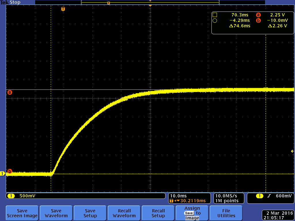

I measured TMDS171EVM OE pin voltage with 0.1uF cap connected to this pin to GND. I had the following result.
OE pin voltage did not go over 2.25V, would not go over the VIH threshold.
[Question]
What is the pull up voltage connected through 200kOhm resister inside ?
Kawai
Hi Kawai-san,
The previous values for Vil and Vih I have provided are from the GPO perspective, these values ensure the device is enabled or disable.
If you are placing the capacitor you don't have to worry about the voltage in OE, it will enable the device after Vcc is stable.
