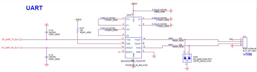

We are using MAX3232 as new project design and I measured waveform as below, does this waveform is normal or not?

Is VDDIO set to 5V? If true then change to capacitors shown in table for figure 6 in data sheet. "C1" = 47nF; [C2, V+ and V-] caps = 330nF
Some ripple is normal due to the nature of regulated charge pumps, however your ripple looks too large.

Thank you for your reply and our VDDIO is 3.3V and the capacitance is 0.1uF correct.
Do you have another suggestions for this large ripple?Thank you ~
