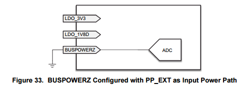

3)There are two signals, HV_GATE1 and HV_GATE2,which are controlling the External FETs of PP_EXT signal.These are Output signals.We have to control the FETs through Registers only?Can we update the corresponding Register to turn the FETs ON and OFF dynamically?Is that register is to be updated through I2C interface by the microcontroller?

    3) The Charge pumps for the PP_EXT power path, pins HV_GATE1/2, are controlled automatically by Boot Code and Application Code, and the PP_EXT is configurable to be dynamically switching between an Input (Sink) or Output (Source).
    Refer to the datasheet, TPS65982 FW User's Guide and the System Configurations tab of the TPS6598X-CONFIG Config Tool for more details:
    • Boot Code- PP_EXT FET Path set in HW by BUSPOWERZ termination (BUSPOWERZ = GND --> PP_EXT Enabled as Sink path in Dead Battery)
    • Application Code- PP_EXT set as Static Input or Output (enabled/disabled automatically) or a Dynamic In_Out
