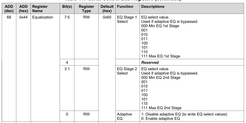

In the datasheet of DS90UB926Q-Q1, we can disable the adaptive equalizer  (to write EQ select value).
Could you please let me know adjustment method of  manual EQ value?
From other post, I got the reply that the register of  EQ stage select is read only.
However, the register is R/W type. If so, we should see the EQ select value detail.

    Did you ever get a response to this question, I would also like to know more about the adaptive equalizer as it doesn't seem to be able to cope with different manufactures cables made to the same specification, a 5M length of 3.3mm usb2.0 cable in my case
