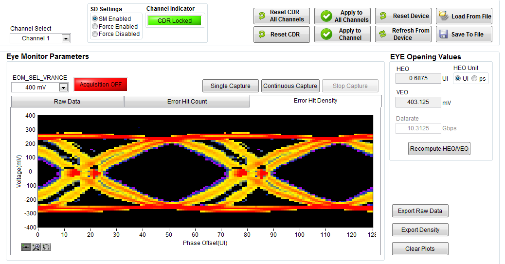

SMBus interface of  DS125DF410EVM is not working. Any suggestion!
Thanks and best regards,

    I am working on your existing software (SigCon Architect) but as long as I have 12GHZ output from this board, it is enough to make me happy.
    Can you send me full link which I can find related information for DPS-DONGLE-EVM and the link which I can order?
    In short term, is there any way to communicate with this board. I have a I2C master and can program to communicate with this board. Or if you have any other suggestion, please let me know. While waiting for this dongle, I would like to try all possible cases to communicate with this board. Again, I just need a signal output with 12 GHZ from this board.

  • Hi Michael,
    I successfully communicated with the board through SMBus (I2C). I can write and read the register content. My objective is to create a 12GHZ signal out of this board.
    I need you guidance for programming the minimum set of registers to get 12GHZ pattern that I can look at the eye diagram.

    I would like to use PRBS generator while VCO in free running mode in order to generate 12GHZ pattern in PRBS-9 PRBS-31 format.
    In free PRBS running mode, do we need the input signal?

    You are correct, it is possible to program the DS125DF410 so that a PRBS signal will be output.  This does not require a signal on the input.  Please note that the VCO is "free-running" in this case, the output datarate will wander around to some degree and will not be exactly 12.0 Gbps

    Here is a sequence which should enable you to get ~ 12 Gbps data out of the DS125DF410
    Program 0xFF to select channel
    Channel Register          Write Data          Write Mask          Comment
    0x09                                  0x04                    0x04                     Override divider select
    0x09                                  0x80                    0x80                     Override VCO cap count
    0x08                                  0x06                    0x1F                     Set VCO cap count to 06'h
    0x18                                  0x00                    0x70                     Select divider select to 000'b
    0x09                                  0x08                    0x06                     Override charge pump power downs
    0x1B                                  0x00                    0x03                     Disable both charge pumps
    0x09                                  0x40                    0x40                     Override Loop-filter DAC
    0x1F                                  0x12                    0x1F                     Set Loop-filter DAC override value
    0x1E                                  0x10                    0x10                     Enable PRBS Generator
    0x30                                  0x08                    0x0F                      Enable Digital Clock - set pattern to PRBS9
    0x09                                  0x20                    0x20                      Override Loopthru Select
    0x1E                                  0x80                    0xE0                     Output MUX Select PRBS Generator
    0x0D                                  0x20                    0x20                      PRBS Seed Load
    To increase the data-rate, decrease  value of Register Data in 0x08 (Step 3).
    To decrease the data-rate, increase value of Register Data in 0x08 (Step 3).

  • Hi Rodrigo,
    Great! Thank you! I got the signal.
    One more thing on this case:
    What about using external reference clock, My error detection equipment(BERT) and pattern generator(TI DS125SF410EVM) needs to be synchronized through reference clock. How can I program this?
    This chip has also eye monitoring feature. I wonder is there any way to derive Bit Error Rate or approximate through eye monitoring feature of this chip?
  • Hi Bugra,
    The DS125DF410 implements a referenceless CDR architecture. The ref_clk that is provided to our device does not actually clock the high-speed data path. The ref_clk  mainly serves as a counter for the the digital circuitry. For your ease of reference I've included a pic below for a BERTScope BERT instrument. This instrument requires a "clock input" signal to synchronize the "error detector". As the DS125DF410 does not have a high-speed clock output, your alternative would be to drive the error detector single-ended with the DS125DF1410, and use the other signal from the DS125DF410 DUT channel pair to drive the clock input. You may terminate the unused signal input on the error detector to 50 ohm.
    The horizontal eye opening (HEO) and vertical eye opening (VEO) readings from the DS125DF410 by default correspond to a probability level in the order of 1E-6. Channel register 0x2A (EOM timer threshold) allows the user to control the amount of time the eye monitor samples each point in the eye for. If you maximize the value, the probability level is reduced to a value in the range of 1E-9.
    Rodrigo Natal
