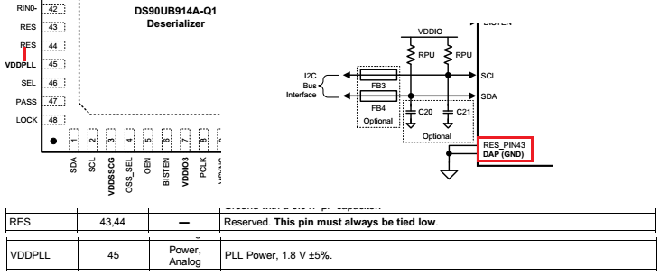

Is it possible to connect RES pins (#43, #44) of DS90UB914A-Q1 to GND via current limit resistor such as 10kohm?
What my customer is concerned that, in the case of RES pins(#43, #44) and VDDPLL pin(#45) which is located just next of RES pins make short circuit at the outside of DS90UB914A-Q1, it results the short circuit between 1.8V supply and GND. In order to prevent excessive current flow to GND, possibly use resistor inbetween RES pin and GND.
