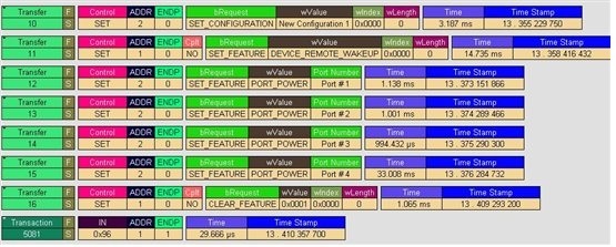

  • That sequence is controlled by the USB host (by the driver), the hub can do nothing to decide which downstream port to enumerate first.
    Just for your information, I've seen that the USB Host usually follow an ascendant order, i.e. Port1, Port2,... but this is not a rule of thumb.
    More than that, I've seen the above sequence when applying power to the port but, after that the enumeration process will be different for each downstream device depending on its Functions, so even if the Port1 is powered up first, the device on Port3 might be finish the enumeration process first.
    Below is a capture showing how the USB host follows a sequence to apply power to each port.
    Regards.
  • Thanks! I chose to wire each of my USB-to-Serial converters with DCD and DSR strapped in hardware, so I can identify which port is which regardless of how they appear in Windows. I appreciate the detailed info.
