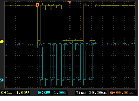

    What we learned is that if we increase the current on the master side (it was set in a "low speed mode") then we don't have this issue anymore, the PCA9546 will respond to its own address even if the pull-up on the 5V channel are to 5V not  3.3V.
    However, we still have an issue. The PCA9546 is set to select channel 1 (3.3V channel) and we are communicating with a single 3.3V device on that channel. The communication works fine for 4 ( master WR + master RD) transactions. On the 5th master WR transaction instead of slave address 0xEC (like I see on previous transactions) what I see is 0xF0 (see bellow scope capture) even though in the firmware I see 0xEC value sent from processor.
    Do we have something wrong with our pull-up values?

  • Hi Valentin,
    It does not look like a pull-up resistor issue as the I2C transactions look ok and you are able to communicate in the first 4 transactions. In the first 4 transactions are you able to turn any channel on/off? Can you take the scope shot at the input (SCL/SDA) and output channel of the PCA9546 during this transaction?
    Rajan
  • Hi Rajan,
    Yes I can turn channels ON/Off. The i2c bus signals look identical at the input and output channel. The problem must be somewhere in the firmware framework of the master - we'll look more into it.
