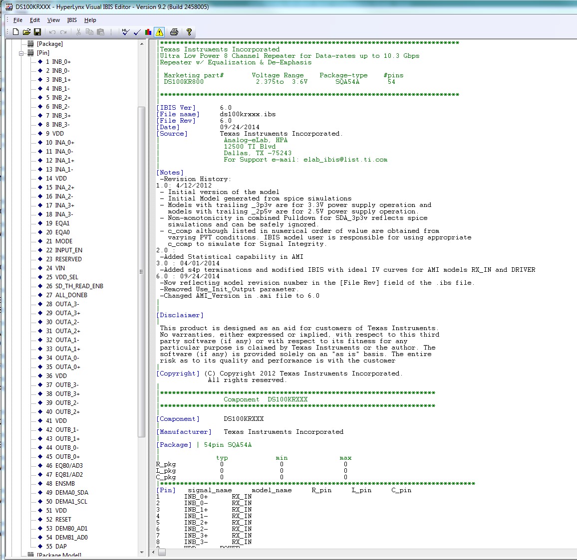

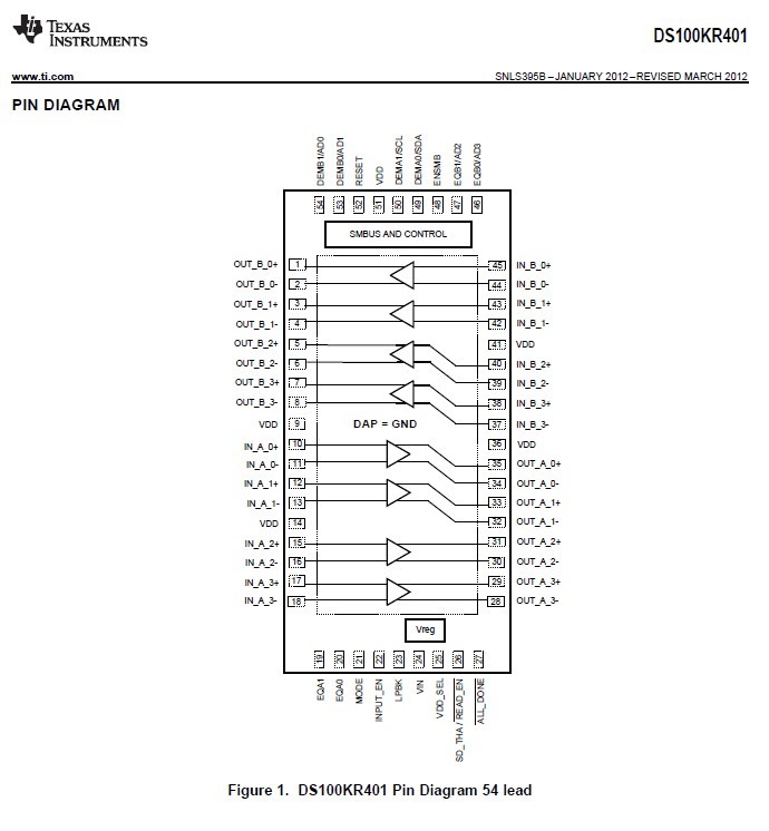

Hi, the IBIS model for the DS100KR401 shows pin 1 and 2 as inputs yet the datasheet shows them as outputs.  Which one is correct?  If the datasheet is correct, is it possible to get an updated IBIS model?

    This model supports both DS100KR800 and DS100KR401.  The primary pinout listed in the .IBS file is for the DS100KR800.  I have highlighted the text changes below to remap the DS100KRxxx.ibs file to have the DS100KR401 pinout.
    Lee
    Default Model Configuration DS100KR800 pinout
    [Pin]    signal_name     model_name    R_pin    L_pin    C_pin
    1          INB_0+               RX_IN
    2          INB_0-                RX_IN
    3          INB_1+               RX_IN
    4          INB_1-                RX_IN
    5          INB_2+               RX_IN
    6          INB_2-                RX_IN
    7          INB_3+               RX_IN
    8          INB_3-                RX_IN
    37       OUTB_3-            DRIVER
    38       OUTB_3+           DRIVER
    39       OUTB_2-            DRIVER
    40       OUTB_2+           DRIVER
    42       OUTB_1-            DRIVER
    43       OUTB_1+           DRIVER
    44       OUTB_0-            DRIVER
    45       OUTB_0+           DRIVER
    [Diff Pin]      inv_pin        vdiff       tdelay_typ       tdelay_min      tdelay_max
    1                   2                  200mV
    3                   4                  200mV
    5                   6                  200mV
    7                   8                  200mV
    38                37                NA
    40                39                NA
    43                42                NA
    45                44                NA
    Changes to Model Configuration for DS100KR401 pinout
    1          OUTB_0+               DRIVER
    2          OUTB_0-                DRIVER
    3          OUTB_1+               DRIVER
    4          OUTB_1-                DRIVER
    5          OUTB_2+               DRIVER
    6          OUTB_2-                DRIVER
    7          OUTB_3+               DRIVER
    8          OUTB_3-                DRIVER
    37       INB_3-                     RX_IN
    38       INB_3+                    RX_IN
    39       INB_2-                     RX_IN
    40       INB_2+                    RX_IN
    42       INB_1-                     RX_IN
    43       INB_1+                    RX_IN
    44       INB_0-                     RX_IN
    45       INB_0+                    RX_IN
    1                   2                  NA
    3                   4                  NA
    5                   6                  NA
    7                   8                  NA
    38                37                200mV
    40                39                200mV
    43                42                200mV
    45                44                200mV
