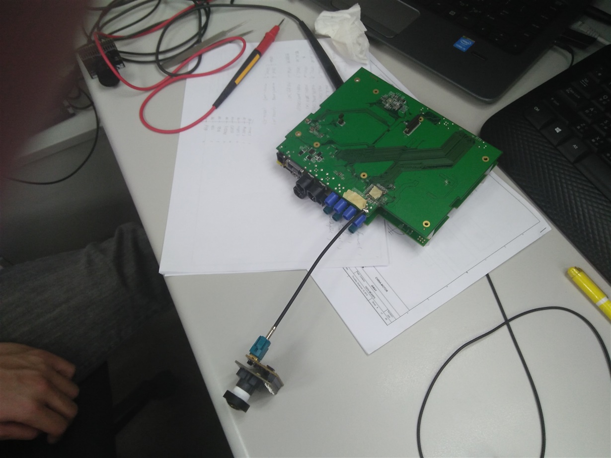

             Customer refer to FPD-Link reference do a 914 Deserializer board that is connect to camera board with 913. But the communication are not successful between 913 and 914. Lock and Pass pin are always Hi/Lo and can't keep already normal high. But use the same camera board, register setting and cable with 914 EVM. That works normal between 914 EVM and 913 camera board.
             Do you have any comments to solve this issue? Thank you.

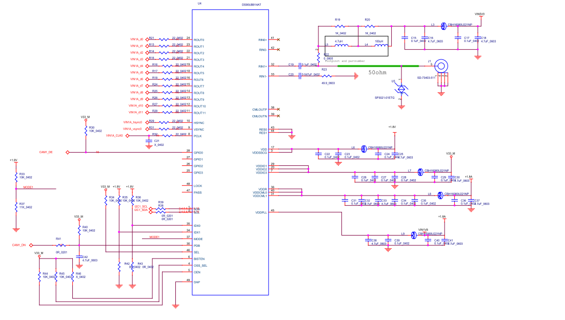

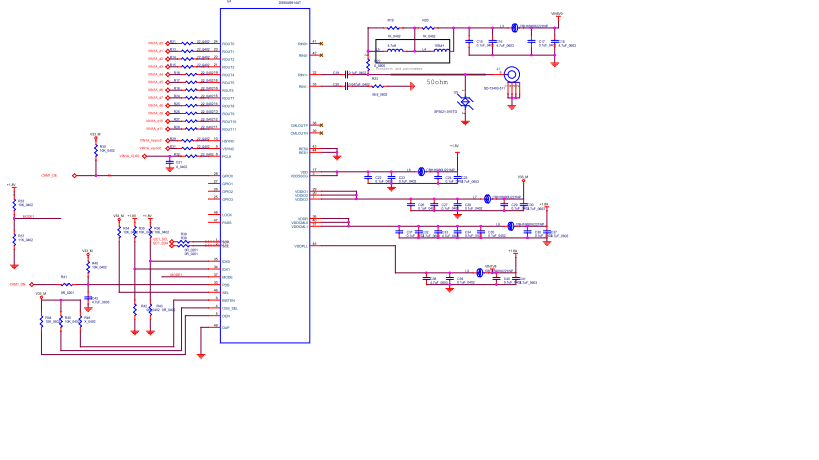

  • Dear Muthukumar,
                       please refer to below schematics of 914 on customer board. 913 is on camera board for customer outsourcing. Thank you.
  • Dear patrick,
    As per schematic, everything is ok.
    u have used IO's at 3.3V and rest at 1.8V.
    i assume that i2c pull-ups will be at Master microcontroller and CAM1_DN input connected at PDB is high, am i right?
    Please check/do the following:
    1. Keep your cameras at reset or pdwn mode
    2. Ensure PDB is high.
    3. After power on, within few milliseconds lock should be high, indicates link is established. but you have mentioned lock as low......isn't it?
    4. if lock is high, do dummy write in Des(say setting ser alias) first then read auto-loaded Ser address in des register. if u are able to read then ser link is fine.
    5. By default Ser-Des is in pass through mode, but please check its register to confirm the same.
    6. Set ser alias in Des and try for i2c commm to Ser using alias address.
    mail me what u observe?
