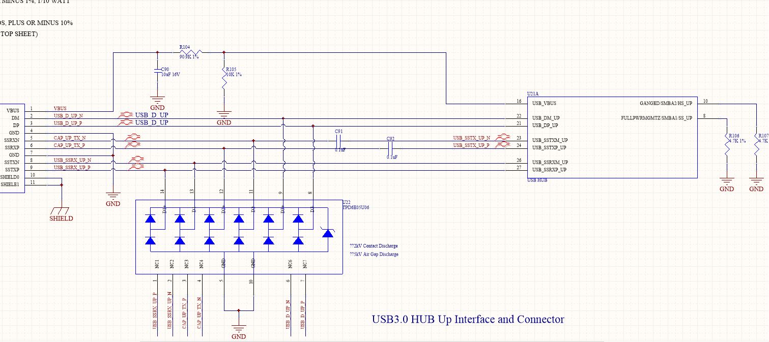

I designed a USB HUB board with TUSB8041-Q1, 3 down-stream USB 3.0 ports and 1 down-stream USB 2.0 port. I connected two high resolution USB 3.0 cameras from the following link, with the HUB board connected to PC.
The camera manufacture provides a PC GUI "IC Capture" so that I can see if the cameras are streaming frames to PC. The cameras work for about 1~3 mins, then I get frozen frames.
I tested with another HUB (VL812 chip), same connection to PC, no problem.
What could be the issue? I did design my hub board with attentions to matching differential length, impedance, etc following the "TIDA-00288 4-Port USB 3.0 Hub Reference Design.pdf".
