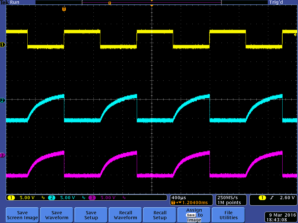

We have a problem about MAX3232EIPWR in our customer's product. Please see the attached picture.
   -  Ch1 : Din1 / Din2
  -  Ch2 : Dout1
  -  Ch3 : Dout2
Measure conditions are follows.
  -  Vcc : 3.3V
  -  Dinx : 3.3Vpp / 1kHz
This individual can't makes +5V. I guess the V+ charge-pump of this individual is broken.
We tried measurement to using the curve-tracer and X-ray camera for it.
However, we could not find the issue.
I have tow questions.
  -  Is fault location the V+ charge pump?
  -  Know the same precedent?
