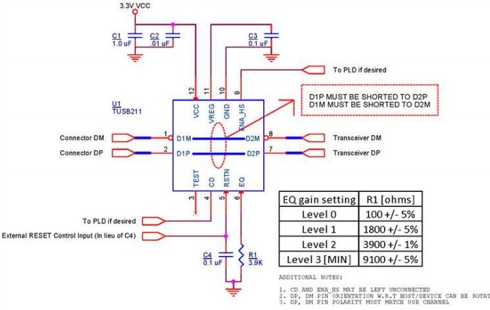

My customer have two question about TUSB211.
The first one is that the datasheet shows the D1P and D1M should be connected with D2P and D2M respectively. They want to know why the high speed signal will not be bypassed by the trace between DxP and DxM. They are curious about the method to implement this.
They have another question, that is do they need to add more than one re-driver in a signal chain? What if they use two or more in the system? Such as one is placed near the core processor, another is placed nearby the USB device. Will this have better performance? Have you ever met such application? And do you have related testing data?
