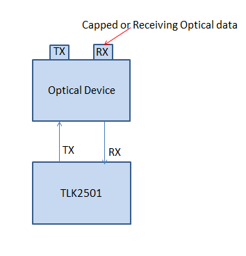

【Connection】
Optical Device RX(Capped or receives optical signal) ⇒ TLK2501 RX(DINRXP/ DINRXN)
TLK2501 TX(DOUTTXP, DOUTTXR) ⇒ Optical Device TX
Optical device RX has cap(No Optical signal). In this situation, TLK2501 send TX data to the optical Device, then the optical Device detects CRC Error.
If optical device RX receives optical signal, then CRC error doesn't cause on TX side of optical device.

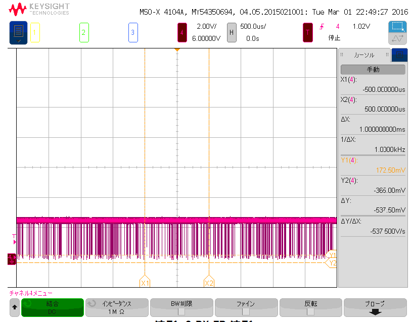

(1)No optical signal(RX)
  ①RX_DV/LOS ⇒High Level、RX_ER⇒ toggling High or Low level after power like following.
   I think it should causes just High level of RX_ER, but causes Low level frequently.
   In other words, RX Error and Normal Operation causes repeatedly like following waveform.
  ■RX_ERR Waveform■

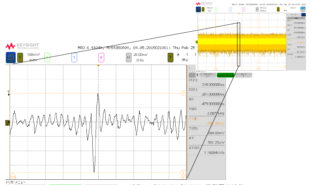

  ②DINRXP and DINRXN receives 550mVp-p differential signal like following.
    This differential Voltage signal is input from power on.

1.)
RX_ERR causes toggling like High or Low. Do these RX_Err effect TX serdes operation like TX data error?
2.)
DINRXP, DINRXN got 550mVp-p differential voltage, does it cause RX_ER toggling behavior like waveform?
Is it expected behavior for TLK2501?
