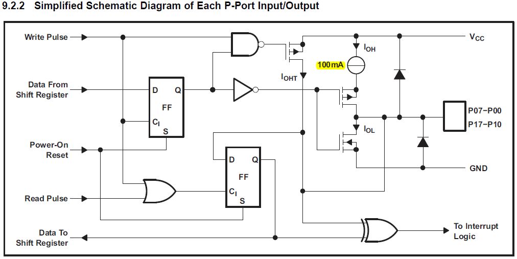

Anyway, I have one question about below block diagram.
When I/Os are high, IOH current source is about 100uA, isn't it?

  • Toshi-san,
    I've contacted the correct application engineer for this specific part to respond to your question. While we wait, I'll respond with what I can:
    One question about block diagram: Yes, the current source allows up to 100 uA typical. The -30 to -300 uA is over the full voltage range, and takes process variation into account. This is why the IOH value is bigger than the block diagram.

     I am sorry that the block diagram was not attached.
    According to the below block diagram, IOH is 100mA instead of 100uA.
    Is it a typo?

  • Toshi-san,
    You are correct. This is  a typo. It should be 100 uA.

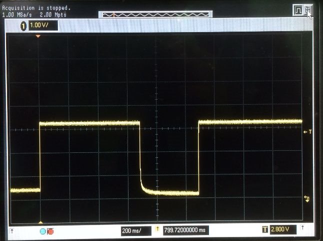

    I got the Vcc wave form when they did the test.  And I found there is 200mV or 300mV bias
    when Vcc is off.  When this bias is removed or is decreased, the strange issue becomes little.
    However, Vcc is down to the minimum Vporf (0.767V), so I think POR should work well.
    The ramp up time is about 1.4ms and the ramp down time is about 40ms (3.3V to 0.5V).

    About the bias, Vcc is not down to 0V at Power OFF condition when they did the Power ON/OFF test.
    And about 200mV or 300mV is remained at Vcc OFF condition.
    When they did the cold reset from Vcc=0V, the device did the reset correctly.
    I hope that my answer is a help to your question.

  • Toshi,
    Do you have a schematic and layout that you can provide?
    Can you also provide scope shots of the Vcc in addition to one of the outputs?
