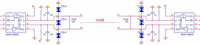

Dear Sirs
I use SN65176B  like the following figure. ( figure 1)
Left SN65176B  is setting for receiver. Right SN65176B  is setting for transceiver.

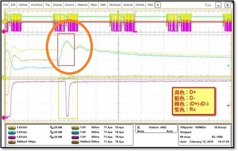

When I disable right SN65176B transceiver (DE disable), the output D+ D- will like the figure 2 (red).
And the Left SN65176B receiver Rx will work NG. figure 2 (green).

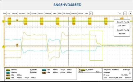

If I use SN65HVD485ED(the same circuit), test is ok (figure 3 (green).)
