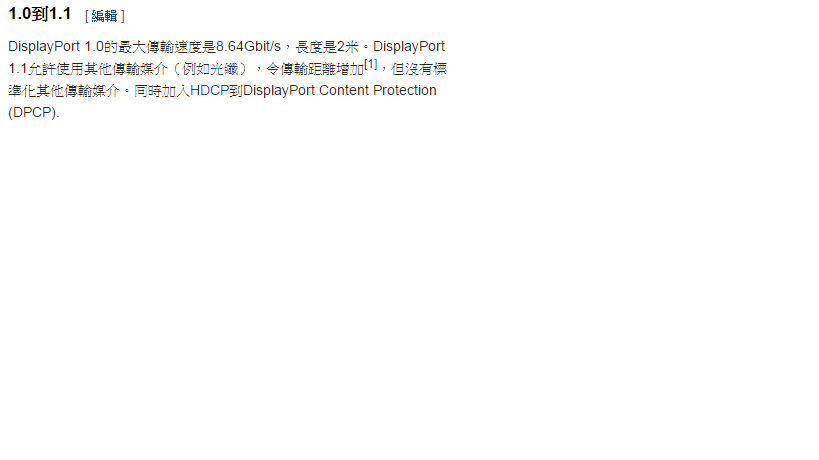

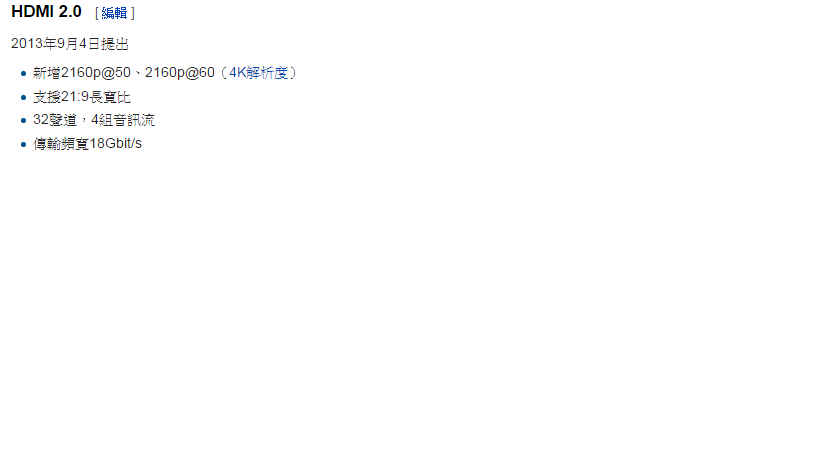

              Customer use Intel skylake platform support DP 1.2, but DP159 support DP 1.1. Can it use for DP to HDMI that support
4K/2k @ 60Hz?
               DP159 looks support DP  6-Gbps and HDMI 2.0 6-Gbps. But the standard of DP 1.1 and HDMI 2.0 looks support higher data rate. Has any wrong for my understanding? Thank you
