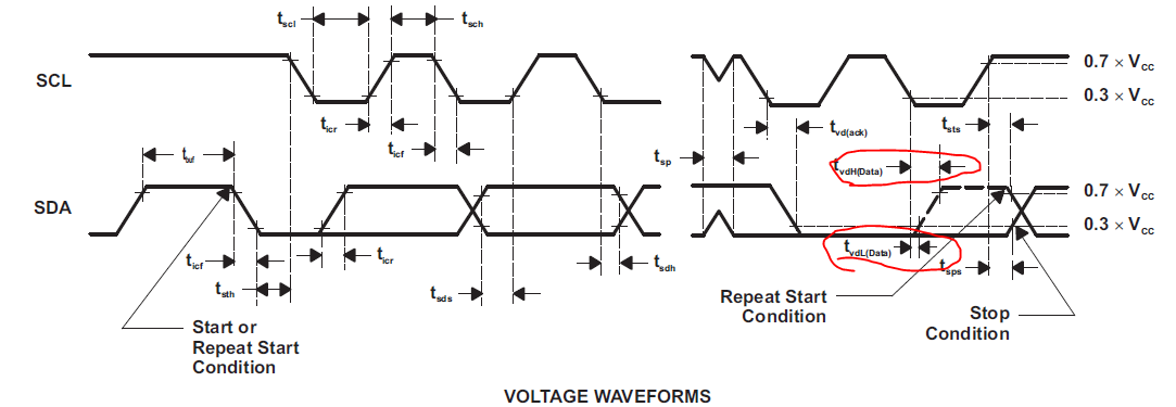

I found in PCA9548A datasheet that tvdL(Data) and tvdH(Data) time value is not aligned with picture showed in the same datasheet as below.
From Voltage waveform picture, tvdH(Data) > tvdL(Data), but in table, tvdH(Data) < tvdL(Data).
From general understanding, tvdH(Data) should be > tvdL(Data).
Which one is correct here?
Thanks.
