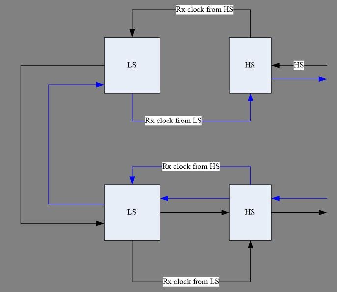

Hola,
Can someone help to confirm the clocking architecture as below whether is correct? Thanks so much ~
Other Parts Discussed in Thread: TLK10002
Hola,
Hola Luis,
Thank you for your reply, we hope use this device to achieved bi-directional access the data and frequency.
HS_A --> LS_A --> LS_B --> HS_B, HS_A recovery clock and HS_B use HS_A recovery to transmit
HS_B --> LB_B --> LS_A --> HS_A, HS_B recovery clock and HS_A use HS_B recovery to transmit
Does this device whether has transmit clock source?if yes, how can I do?
