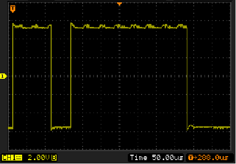

We have a MAX3232 that works fine on T1Out pin and I see the data properly on the PC.
However, the data sent from the PC on R1In pin will never show on the R1Out pin. I see the data on R1pin (attached) which looks fine to me.We have same issue with 2 boards.
Vcc is 3.3V and all C1,2,3,4 and Cbypass are 0.1uF. C3 is connected to Vcc instead ground but that is acceptable according with the datasheet.
What could be  issue?
