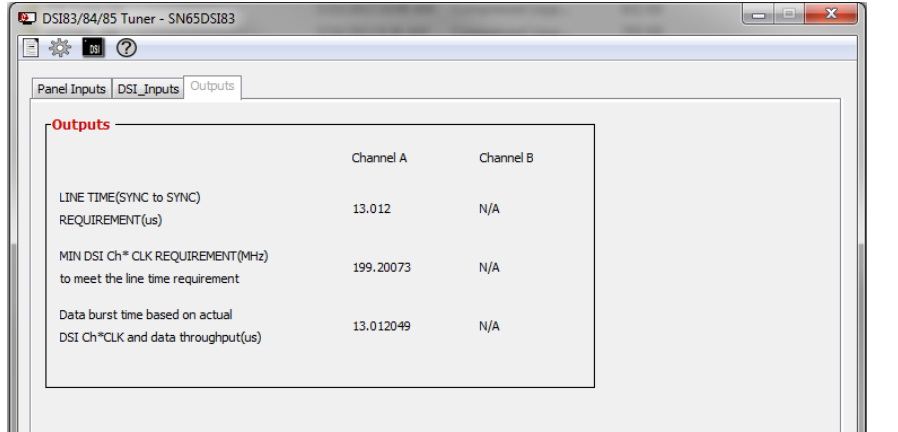

For the DSI timing calculation, the total value matters the most as it relates to the line time(horizontal sync to next horizontal sync). It is critical for the DSI source to output the data per the calculated line time. You need to confirm if the line time matches the DSI tool calculation. See the example below.
Refer to the link below to understand how to configure the registers an get the line time value using the DSI Tuner.
