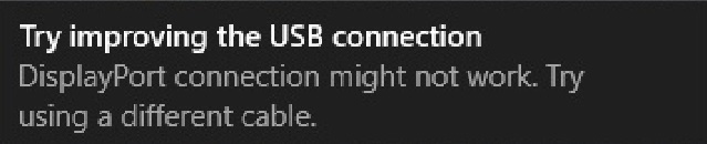

    You could refer to below figure
    Windows 10 (version 10.0.10586) will have below message ,when I insert apple dongle to TPS65982 + HD3SS3212 (doesn't support displayport)
    But this message can not  clearly and could let user know TPS65982 or Apple dongle displayport function is workable or not
    Our customer would like to let user know below
    If the apple dongle displatyport function is workable ,the windows can show "This TypeC port doesn't support displayport Alternet mode"
    Do you have any idea how to do??

    If you have the TPS65982+HD3SS3212 connected to the receptacle of the Apple dongle, the TPS65982 would not be responding with the Billboard message.
    Whatever product is connected to the Laptop (in this case, the Apple dongle's plug side) will respond with the Billboard message. The receptacle of the Apple dongle is only for a charger (power only) and does not have any data capabilities.

    Yes, the TPS65982 and all other TPS6598X parts support the Billboarding feature required by USB PD for Alternate Modes. The Win10 operating system supports the Billboard driver natively and report the Error Message.
    The Billboard feature is enabled by the integrated USB2 Endpoint and the ASCII Strings sent to the Win10 PC can be customized in the TPS6598X-CONFIG Configuration Tool.
