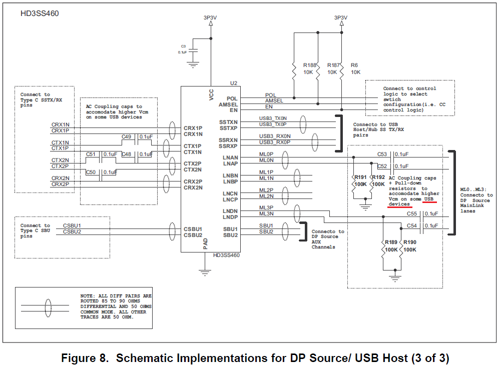

Hi Team,
I couldn't catch what is "USB devices" in the folllowing red underlined.
Does it indicate USB device that is connected through Type-C connector?
(Does it indicate "AC cap + pull-down resistor" in figure 8. accomodates higher Vcm from Type-C connector?
Your support would be appliciated.
Yaita / Japan disty
  • Hello Yaita-san,
    First I would like to mention that the DS has been updated and the image you pointed out is no longer valid, you can find the new version in the product web page. Now, the regarding the questions. These PD resistors are in order to accomodate higher VCM on some devies on the Type-C side.
    Diego.
