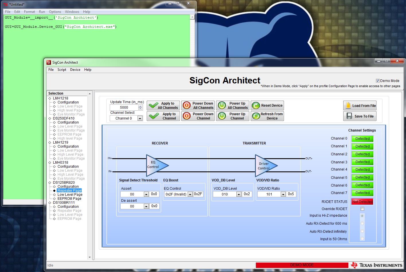

    1. Open the desired profile (in my example, I am using the DS125BR820.
    2. In the top taskbar, click Script-> Launch Window. A new Python window will appear.

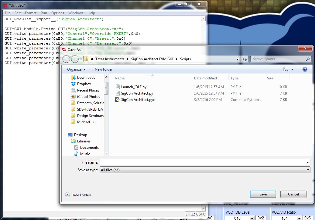

    3. Go back to SigCon Architect and in the top task bar, click Script->Start Recording. Once you do that, the Python window in the background will start blinking green.
    4. Go to the High Level Page and begin clicking through all the desired settings. In my example below, I set EQ Boost to Level 1, then clicked "Apply." Note that in the High Level Page, multiple "Write" commands may be executed, because all drop-down menu settings are overwritten with the latest settings chosen at the time you click "Apply."
    5. When you are done clicking through the settings, you can go to the top taskbar and click Script->Stop Recording.
    6. To save all the read/write commands from the Launch Window, save the Python file by going to File->Save As... in the Python window. Make sure that the file extension is .py.
