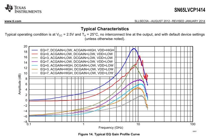

Hello Team,
Could you please provide us the EQ gain curve for SN65DP141 ?
There were EQ gain curve in SN65LVCP1414 datasheet which seems to have almost the same electrical characteristic. Does DP141 has the same gain curve ?
