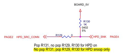

I believe DP159 retimer function would operate even if you don't have HPD_sink signal as long as you disable "HPD auto power down" function. Am I correct ?

    A2. No, HPD SNK must be high for for DP159 to enable its outputs. The HPD auto power down function just enables / disables the low power mode when HPD SNK is low.

    2) I understand. I believe HPD_Snoop circuit would work. Customer is using this.

    2.  HPD snoop will work, but the HPD_SNK must still be connected to the DP159.
