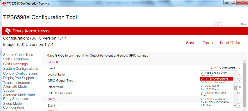

Customer want to have over current reporting for 12V/1.5A PD.
As GPIO menu, I only found PP_5V over current selection, no selection for PP_HV.
May I know how to assign PP_HV over current output event to GPIO?
The FAULT_CONDITION event only asserts for overcurrent conditions on any of the power paths (PP_5V, PP_HV, and PP_HVE)
