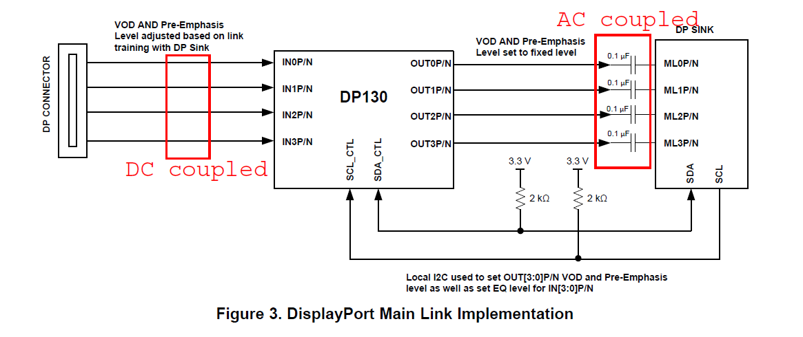

Sn65DP130 input/ouput use AC or DC couple in sink mode ?
We design the Sn65DP130  in sink mode( Dp130 in display LCD ) , my question is   DP130  input DP and output Dp signal need  AC-coupled or DC-coupled.
I think as below,  is it correct?
1. input  signal   in  DC coupled
2.  Output Singal   in AC-coupled.
Thank you!
