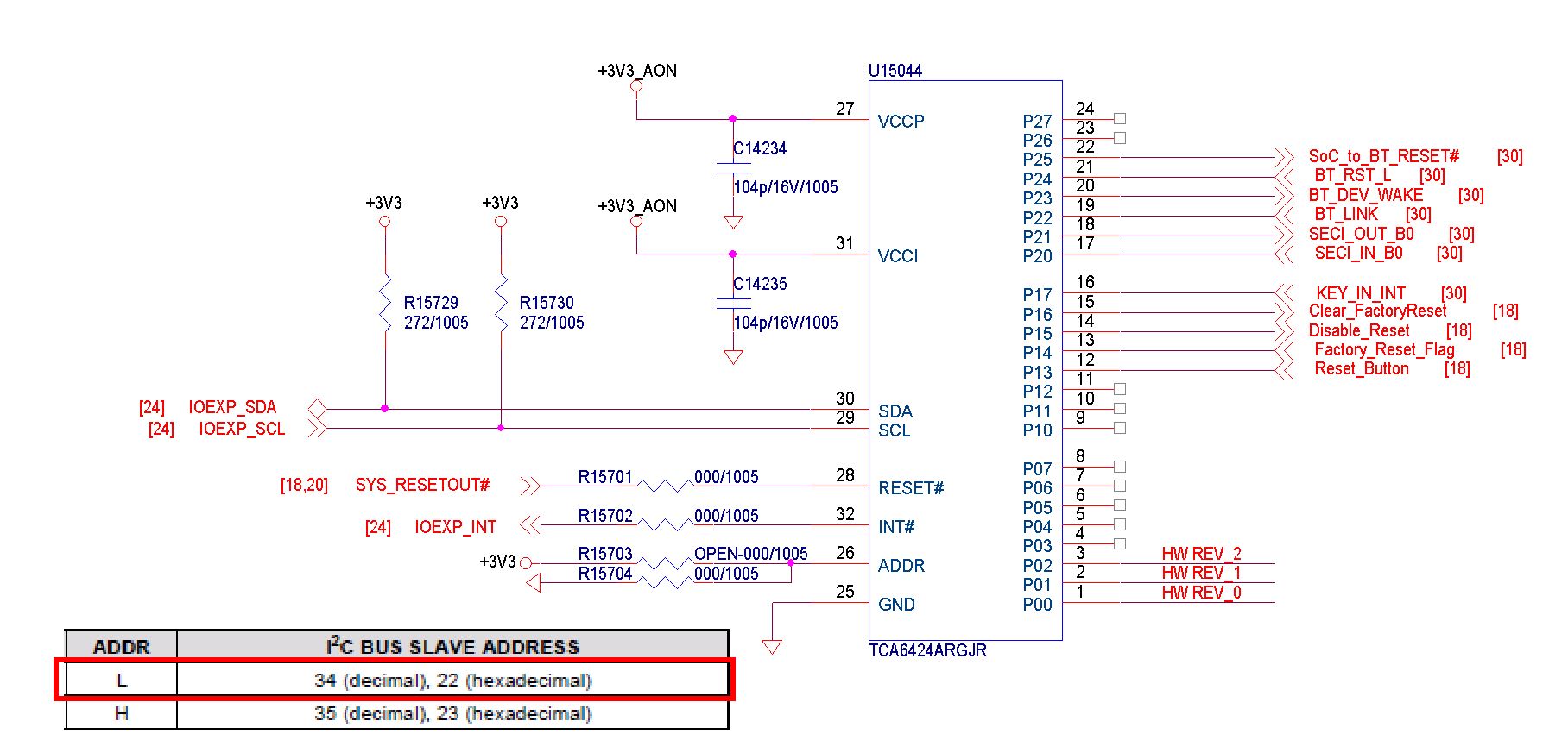

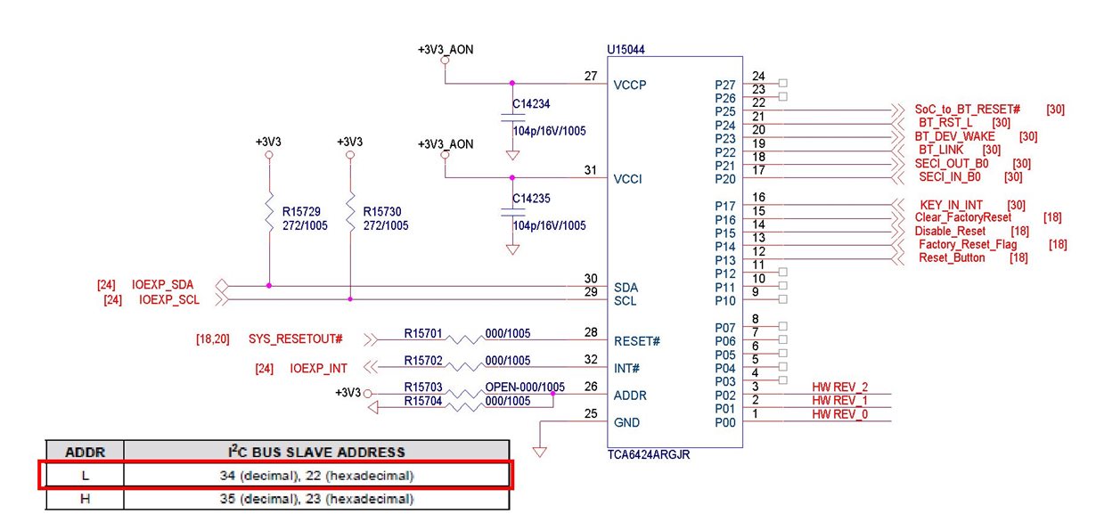

Hi TI,
I'm developing new STB application with TI's TCA6424.
And I want you review my schematic attached.
Please kindly let me know if there's any suspicious point.
I always thanks for TI's pertinent help.
  • Hi TS,
    Thanks for the question.
    My comments for your schematic are to keep in mind that your I/Os that are configured as inputs should not be left floating and will need pullup resistors. Outputs will not need this. Other than that, this should be fine.
    Siby
  • thanks for your quick answer.
  • The only minor caution is be careful with the use of VCCP (+3V3_AON) and the pullups (R15701 & R15702) In certain conditions if the pullup potential of +3V3 and the VCC +3V3_AON are isolated from each other this can cause issues.
    Sometimes in designs like this its easy to use a switch mode supply for each rail and not fully realize that there is a high potential for isolation between the 2 rails. This may be desired for various reasons, but should be carefully reviewed in cases as noted in this schematic.
    Good luck
    Joe
