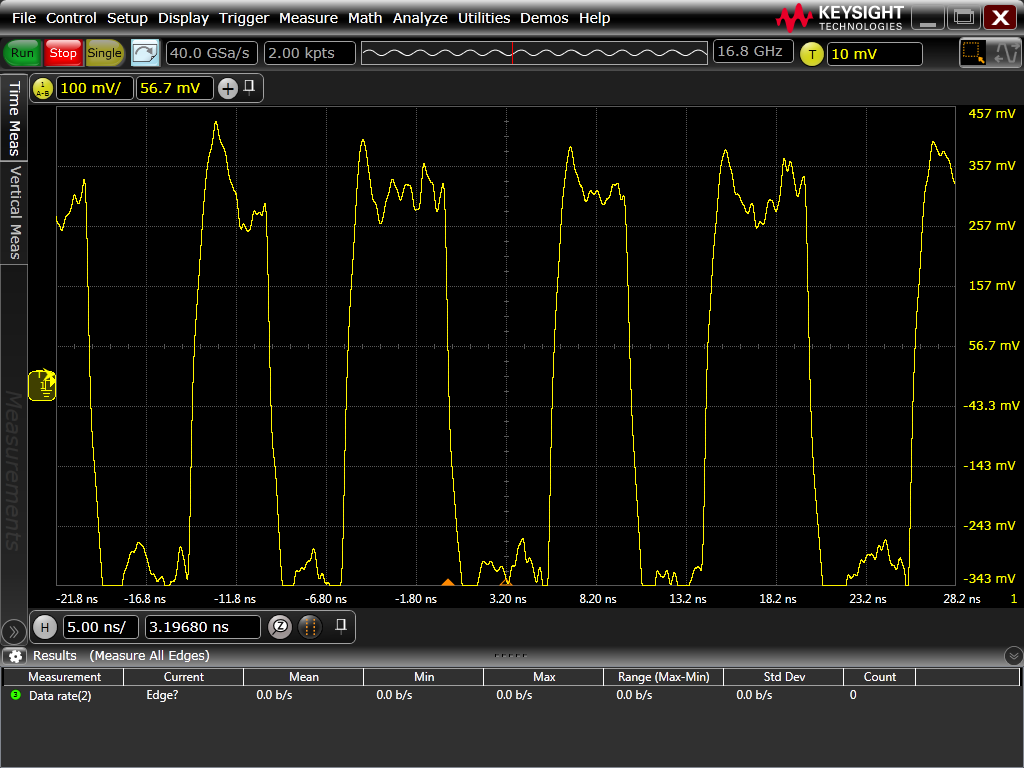

Hi, I'm using the DS90CR481, data sheets say, LVDS clock signal shall be
"1111000" or "1110000" pattern, but it's seems "11110000" and "111000" on DS_OPT applied high and BAL applied high
of clock_in @100MHz. is it something wrong using?

    I'm not mentioned receiver "Deskew" , just about transmitter. Or Datasheet say BAL operates up to clock rate of 80MHz?
    LVDS clock signal  seems "11110000" and "111000" , It  would be "11110000111000" or "00001110001111" so , each 7clocks of  "1-0" signal  transition
    occurs... other word "falling-edge"?
    If you choose to use the DS_OPT pin on the transmitter, then this implies that you are attempting to perform deskew calibration, since the DS_OPT pin (when pulled high) initiates the deskew calibration pattern. According to the datasheet, this feature is only applicable for clock frequencies up to 80 MHz.
    DC balancing (BAL) works across all operable frequencies.
    I am not sure I understand your second question. To help me understand what is happening, can you share some oscilloscope waveforms of the LVDS clock and data when DS_OPT = High and DS_OPT = Low, so we can analyze what you are seeing? More specifically, can you measure the amount of time per period where the LVDS clock signal is high?

    Oh, I've only  the waveform LVDS clock signal at case DS_OPT = High.
    It is intend to that 'Transmitting with no use deskew , use DC balancing @ clock in is 100MHz' .
    so DS_OPT = are fixed 'High' all time.
    So, When I get eye-pattern of the data signal, I have to trigger to falling-edge of LVDS clock.
    And make recovered-clock 7 times.
    I looked at the waveform, and the waveform seems quite noisy.
    I am wondering if the waveform is a valid test case, since you are not planning to use the Deskew feature and only need DC balancing. If this is the case, then DS_OPT should be held low all the time (or left open, so the internal pull-down resistor will keep the pin low), not high all the time. I think in your current situation, the DS90CR481 will attempt to implement the beginning of the deskew procedure, but if it is held high all the time, the deskew process will not complete. Moreover, this deskew procedure, as mentioned previously, is only supported up to 80 MHz.
    Are you seeing system issues with your current setting with DS_OPT = High at 100 MHz because of this behavior? If so, what kind of problems are occurring in the overall system?

    The waveform seems  noisy,it may influence of the refluection of signals, in other word "not so good Sdd11".
    "DS_OPT should be held low all the time..", but  the DS90CR481 could be finished or exit the deskew operation?
    In datasheet say both "Cable Deskew performed when TTL level input is low" ,"Setting the “DESKEW” pin to low will disable the deskew operation and allow the receiver to operation on a fixed data sampling strobe. In this case, the ”DS_OPT” pin on the transmitter must then be set high."
    Those are could be a reason to set the DS_OPT to LOW?, in my case ,I think.
    Why the datasheet not say  The time of " deskew operation time",  "Set the  DS_OPT = high - low -high on the case of Using DESKEW @reciver" or    ”Set the  DS_OPT = high-low to Enter deskew operation”  and "Set the  DS_OPT = low - high to Exit  deskew operation".
    Which pattern should I'v noticed.....
    Yes, I'v a problems that is Verifing the waveform of Eye-pattern. I need to verfy the the waveform of Eye-pattern on all the line.
    Some lines are good Eye-pattern. but Some lines are bad Eye-pattern. So I thought need to suspecting behavior of the clock signal's  .
