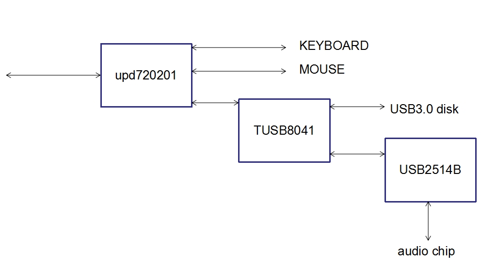

My customer used TUSB8041 to expand USB port. The former device was upd720201 (PCIe to USB controller).
The schematic would be found in the attached file.
04_Peripheral _ 45_USB HUB.pdf
When a U disk (Sandisk USB3.0) was inserted into  UCB connector then connected to TUSB8041, customer found sometime the U disk didn't be found by the system.
The TUSB8041's Vbus and reset signal were pulled to the normal value until upd70=20201 powered up and work. Is it true?
Would you share your comments to this issue?

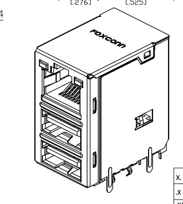

    4. What is the "UCB connector"?
    Q:
  • I reviewed the schematic and only found one thing:
    The value of the resistor in USB_R1 is too low, that could explain a random failure, please use 9.53k-ohm.
    Are the other TUSB8041's downstream ports working well when the Udisk issue happens?
  • Hi Elias
    The USB_R1 resistor was changed to 9.53kohm but no improvement.
    and the orhter tusb8041's downstream port did work well.
    We need a USB protocol trace between the TUSB8041 and the Udisk.
    Is the failure present only on that particular port of the Tier-2 TUSB8041? are the audio device and mouse/keyboard working well when the issue happens.
    Is the Udisk dropping to USB2.0?
    Can you get a scope capture of the RX_Termination polling process?
