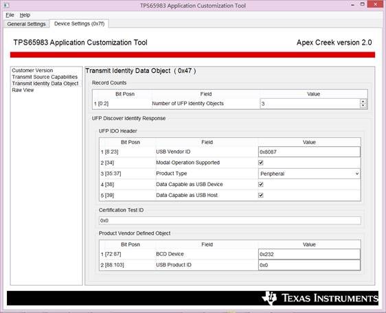

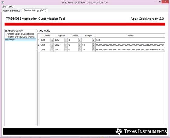

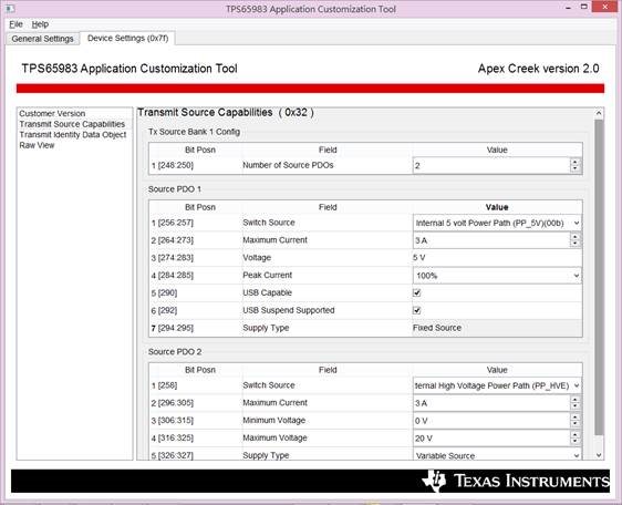

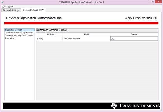

We got configuration tool for TPS65983, then try to generate binary code based on TI’s default project for Intel Apex Creek v2.0
And may we have you doing favor or guide us the below setting is correct or not ?
