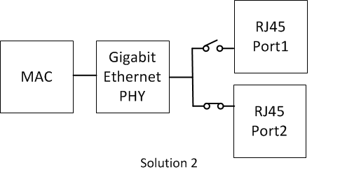

Dear experts,
The customer have only one Ethernet MAC in the processor, and want to support TWO RJ45 port. I think there have 2 solution like below figure shows, really appreciate you can have some suggestion about which solution is prefer and which PHY(support Gigabit) and switch device can be used for the solution?

    If the customer wants to retrieve information from both ports at the same time, they will need a 3-port switch and 2 PHYs.
    If they want to manually choose between the 2 RJ45 ports, this can be done with a MUX on the RJ45 ports. This can be done with a TS3L501E device.

    Thanks for your help, and I think TS3L501E can work for the switch solution for below diagram. so the analog switch is after the PHY and before the transformer, right?
    and I still have an confuse if the customer want to support 1000M Gigabit ethernet, could you have an advise for the bandwidth 600MHz of TS3L501E is enough.

    You are correct about the placement of the TS3L501E.  It would be placed between the PHY and the transformer.  This would mean using 2 transformers and 2 RJ45 ports.
    The TS3L501E has enough bandwidth to work with 1000M Ethernet.  The analog bandwidth of 1000M is much lower than the data rate.
