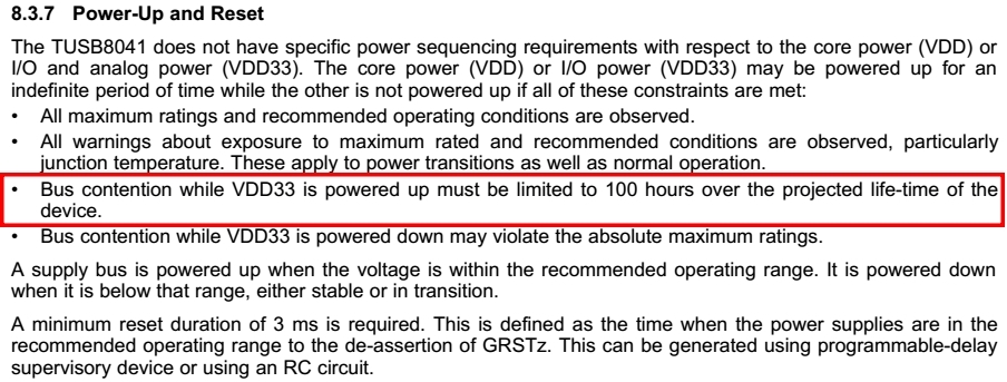

Hi All.
Two quetions about the power supply of TUSB8041.
1. How to understand the description marked by red? It is confusing.
2. If VDD(1.1V) ramp time is less than 0.2ms such as 0.04ms, what will happen?

Hi Elias
Thanks for your comments.
But would you share your comment about my question 2?
