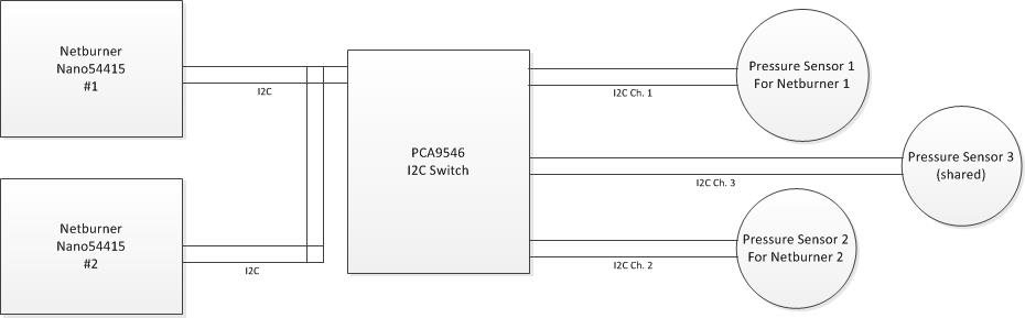

  • Thanks Siby, that clarifies what I was thinking.  I have not had a chance to sit down at a schematic editor yet, but I did make up a simple drawing and wanted to see if this is the concept you are thinking about.
    Its a simple sketch and I did not put all of the pin labels and pull up resistors etc.  but it does get my thought across.
    Note: The Netburner Nano54415 does support multi-master I2C
    Our goal would be that either Netburner could,  when its "its turn",   be able to access pressure sensor 3, all pressure sensors have the same slave address and are not adjustable. Pressure sensor 1 will only be accessed by Netburner 1 and pressure sensor 2 will only be accessed by Netburner 2
    Does this look like it will work?
  • Hi Joe,
    This schematic clears up a lot. Thank you for providing this!
    If Netburner Nano54415 is able to support the multi-master I2C protocol, then there shouldn't be an issue with this configuration.
    Siby
  • Siby thanks for all of your help, one last question,  what are the rules when electrically combining 2 multi-master buses??  Pull-ups etc.
    Joe
  • Hi Joe,
    Standard I2C pullups should be fine for multi-master application.
    Siby
