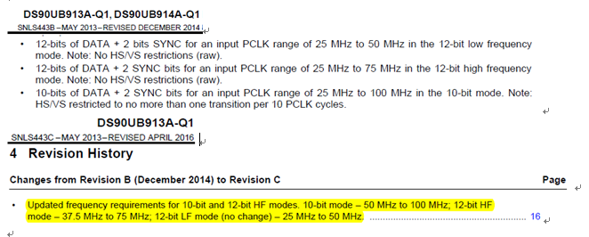

We just received a new spec. of DS90UB913A-Q1 and DS90UB914A-Q1.
I found that the operating frequency range were changed to input PCLK.
Our current design is set to 10-bits mode, and uses 25MHz PCLK,
to new spec. that will be out of spec.
Could you help to clarify this change?
1. Does it have Change Notices (PCN) document, what is the change reasons?
2. For existent users and design, how to recover this design change?
