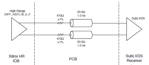

There is a potential problem of LVDS<>SubLVDS mismatch, but based on Xilinx' xapp582 we decided to invest time in a small testboard (since devkits are not available and our local rep couldn't get us anything similar). xapp582 advises to put series resistors close to the transmitter, which we did to get the signals within the recommended operating range of the SN65LVDS310.

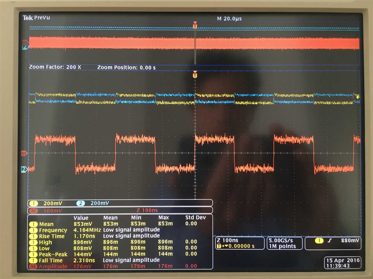

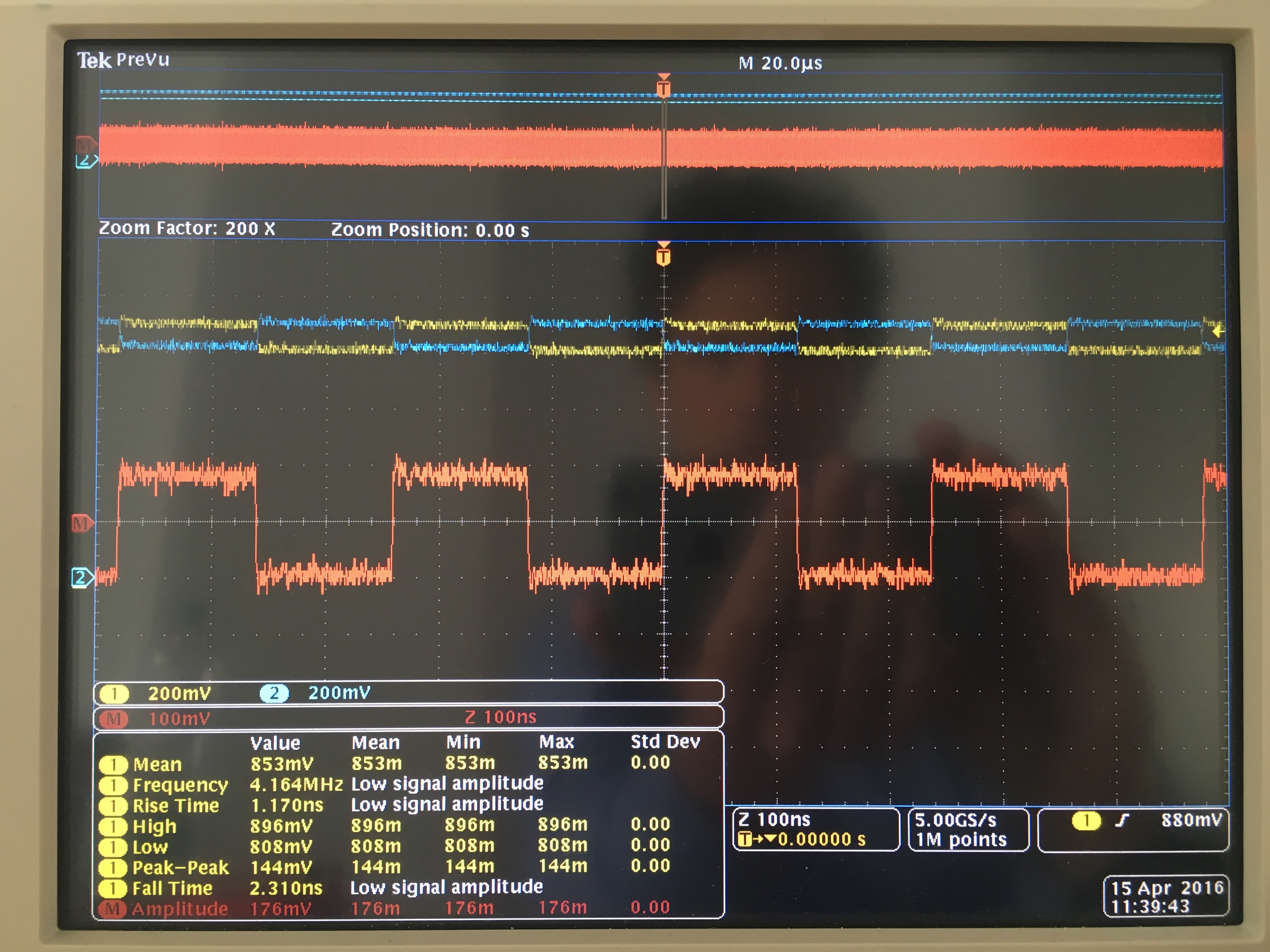

Below is a screenshot of how what the 4.167MHz clock signal towards the SN65LVDS310 looks like. Yellow/blue are the CLK+/-, red is their difference, indicating a 176mV differential amplitude, well within the 70mV-200mV range specced in the SN65LVDS310 datasheet. (measure using 1GHz passive probes on 1GHz bandwidth scope, 1MOhm termination)
However, the SN65LVDS310 is not reacting at all. Regardless of the Data lines (which are presenting a fixed value at the same voltage levels as the clock), we believe the SN65LVDS310 is supposed to produce a 4.167MHz clock. But the clock output is staying low, as well as DE; while other outputs are high. (most signals connector to other non-driving ICs; while the clock output is floating)

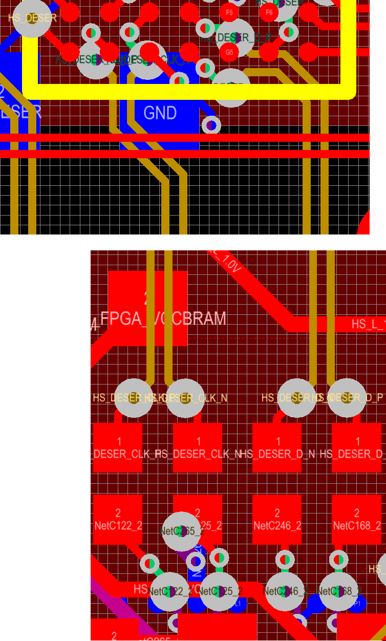

- Traces between transmitter resistors and receiver routed as 100ohm diffpair, 3cm runlength (see below)
- No termination resistors used at receiving side (as they are assumed to be internal) (see below)
    If PCLK and DE are static low that means the device is not receiving a valid input clock, what is the DC level on the input clock?
    The device could be going to stand by mode.

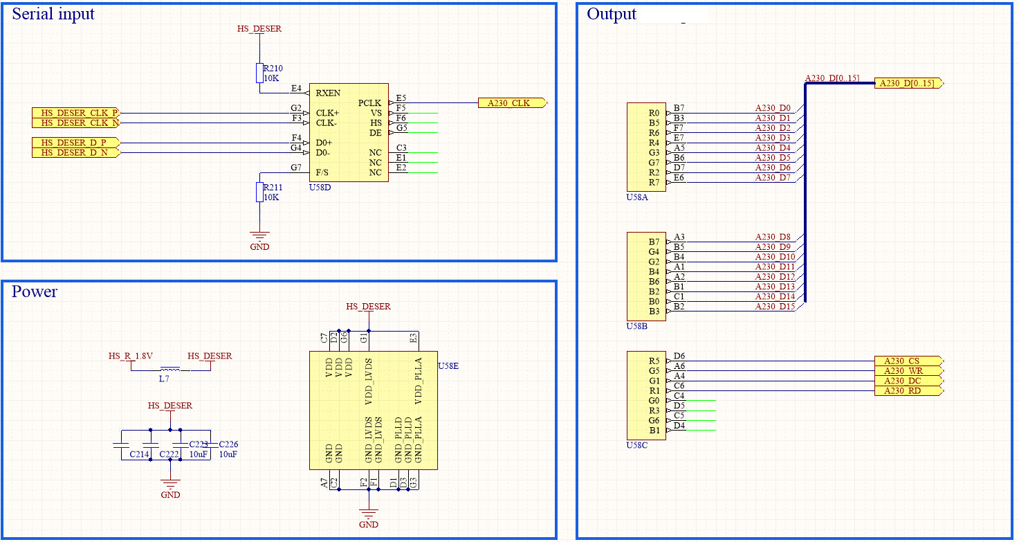

    Can you share your schematic?
  • Thanks for the reply.
    1/ The CM voltage on the input signals is around 850mV (see the scope screenshot above for more detail)
    2/ Schematic details below.

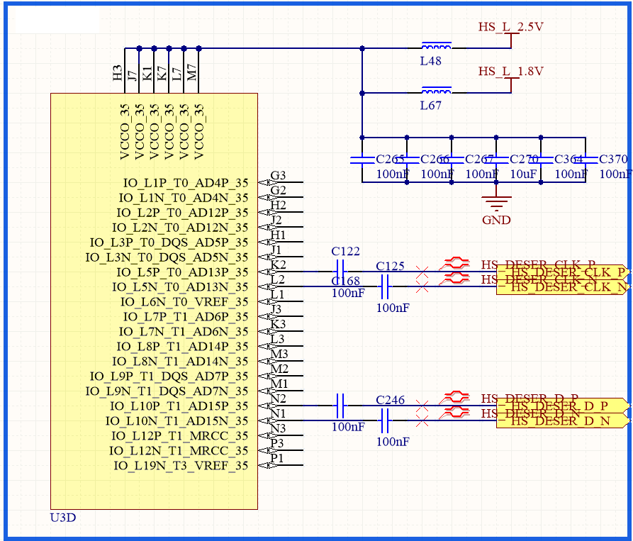

    FPGA first, where we have a full bank dedicated for these output signals (so we can play with voltage levels)
    Please note that these cap footprints have been fitted with 470ohm resistors.
    Schematic of the SN65LVDS310:
    Any comments/questions/suggestions welcome.

  • Riemerg, I took a quick look.  It's not clear what the problem is.  One thing you could check is Icc: does it match active, standby, or shutdown mode?  Does disabling the clock have no effect on Icc?
    Next, can you increase the clock VID or its frequency to see if that fixes it?  I think you can exceed 200mV without problem.
