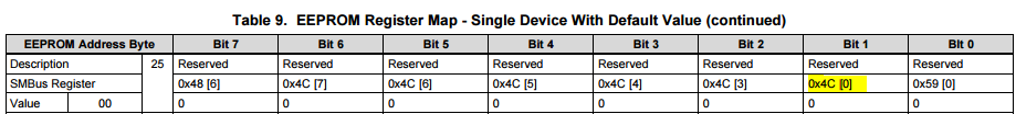

  • Hi Lee,
    Is above SMBus setting exist on DS125BR401A EEPROM? thanks
    Best Regards
    Eddie Chou
  • Hi Eddie,
    Registers to control Signal Detect in the previous E2E post do not have a location for EEPROM configuration.  The DS125BR401A OOB response can be improved with another register (it is also hidden in the datasheet).
    With EEPROM configuration I recommend to program SMBus register 0x4C = 01'h  (the default is 00'h)
    This register bit is listed in the datasheet EEPROM map on page 22. I have cutout a part of the table below, the highlighted EEPROM location should be programmed with a 1'b1 for better OOB performance.
    Lee
