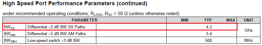

The datasheet shows 4.2GHz(TYP) of BW although bit rate of SuperSpeed requires up to 5Gbps.
Does it satisfy USB 3.1 Gen1?

    USB3.1 Gen1 actually works @ 2.5GHz, since each bit is transmitted on each phase of the period. So a 1010101010... pattern (CP1 compliance test pattern) would look like a 2.5GHz sinusoidal waveform. The same behavior is valid for USB3.1 Gen2, wich works @ 5GHz.
