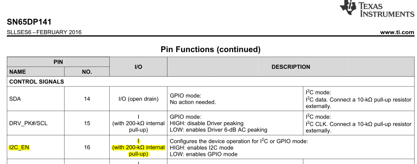

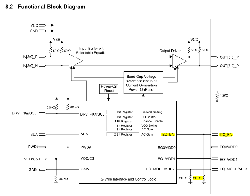

Could you please allow me to confirm the internal pull down/up resistor of SN65DP141 I2C_EN pin ?
I see the below descriptions in the datasheet, one is pull-up and another is pull-down, which is true ?
Kawai
