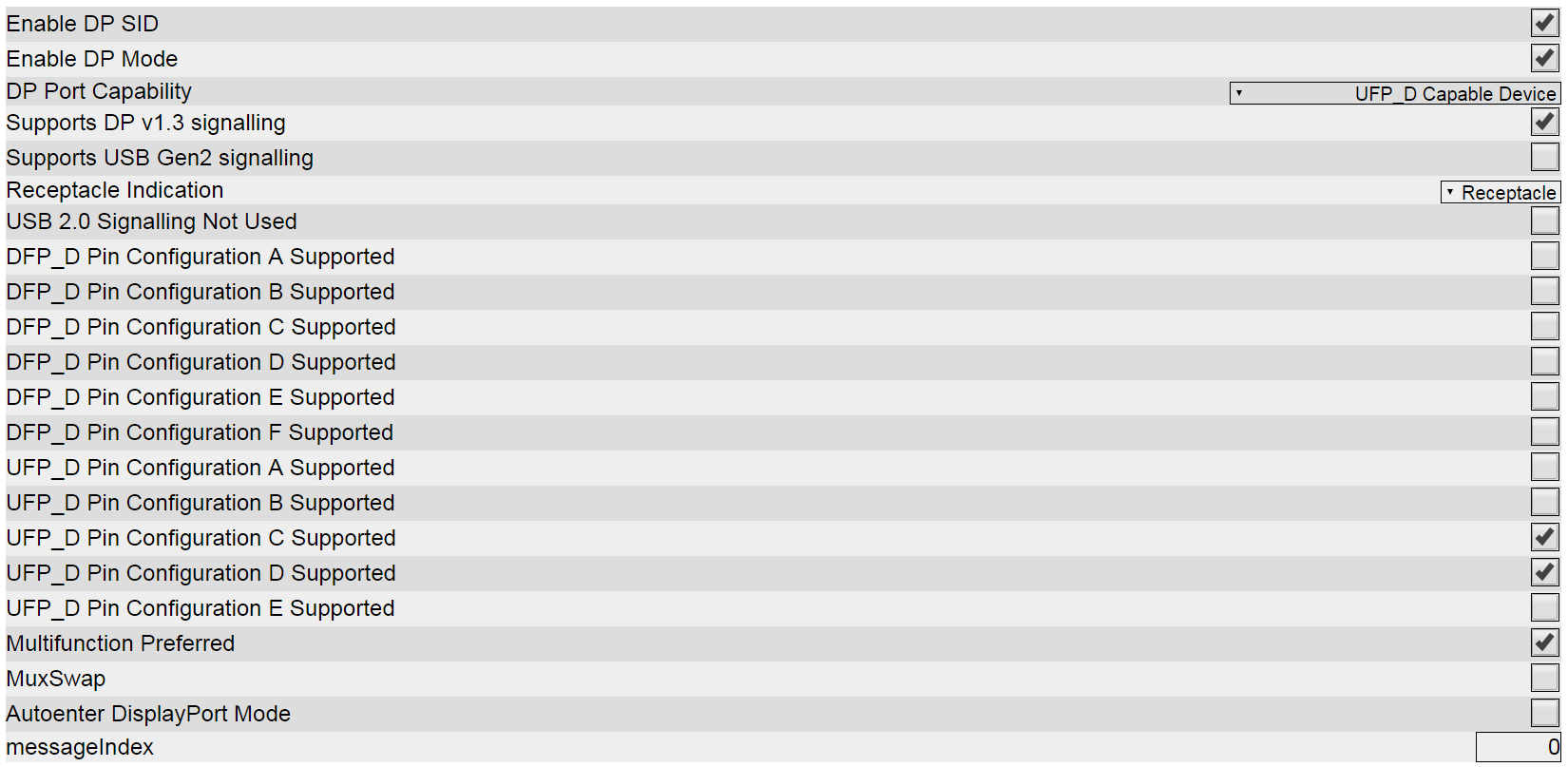

  • Hi Jacob,
    We set the multifunction bit on tool, but there's no data output until now. Can you mail me your project setting to gary.teng@arrowasia.com? Thank you very much.
    Gary
  • Hi Gary,
    Please use the Host Interface tool and confirm the settings below. (0x51 Display Port Config)
    When you connected the dock check the Data Status (0x5F) register and verify the following for DP Pin Assignment D (Multi- function)
