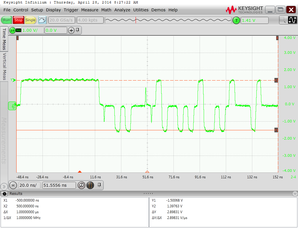

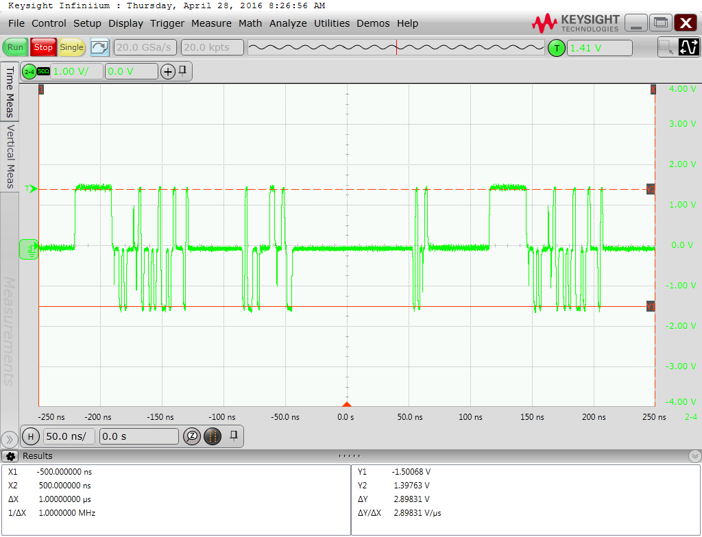

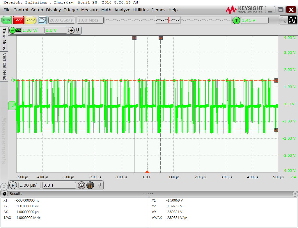

To test the repeater, I'm using an Ethernet Tester to generate a high traffic load with random payload data. The ports of the tester are forced to 100 Mbit Full Duplex. The DP83867IS is configured for Auto neg. (SGMII enable is the only external strap setting, the other settings are default) . The 100 Mbit FD link is established successfully on both PHY. I send data through the repeater and loop the data back at the other side. So both directions are tested and working. However sometimes I discover that the connection is interrupted and no Ethernet data is transferred. I'm not able to reproduce this behavior, it happens randomly. Another problem is, that the SGMII connection is not reestablished. So only resetting the PHY will work. This can be reproduced sometimes if I interrupt the SGMII connection manually. In this error state the following data can be measured on the SGMII interface:
Phy 1 sends the following data (decoded 8b10b data stream):
K28.5+, B5- , 1-, 94-, K28.5+, 42-, 1+, 94+, K28.5-, B5+, 1+, 94+, K28.5-, 42+, 1-, 94- .....
Phy 2 sends the following data:
K28.5-, 50+, K28.5-, 50-...
