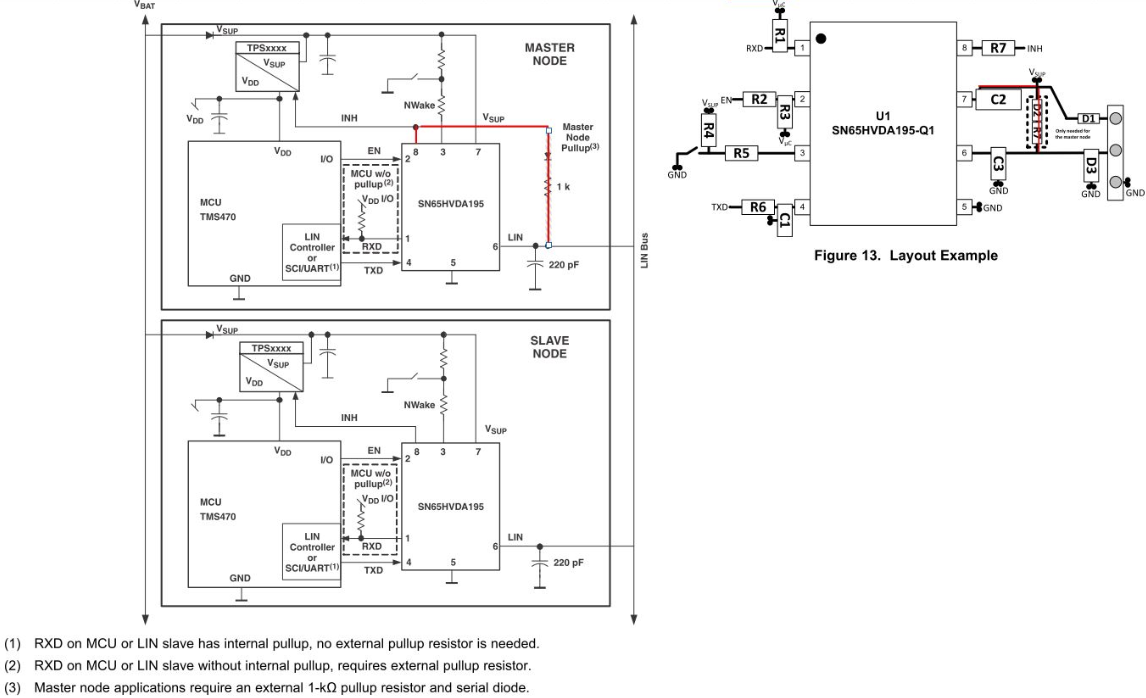

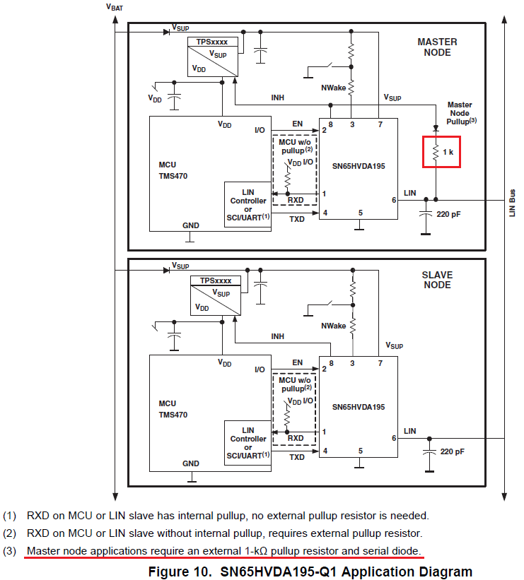

Typical application shows 1kΩ pull-up for Master Node.
Can my customer use the pull-up resistor more than 1kΩ? (2kΩ etc.)
Yaita / Japan disty
I think both the figure are OK.
Connecting pull up series Diode-Resistor to INH pin give an option to reduce power dissipation when micro detect permanent dominant level on LIN pin i.e ground short circuit. In that case series diode-resistor be disconnect by switching transceiver to Low power mode which minimize the power dissipation in fault conditions.
