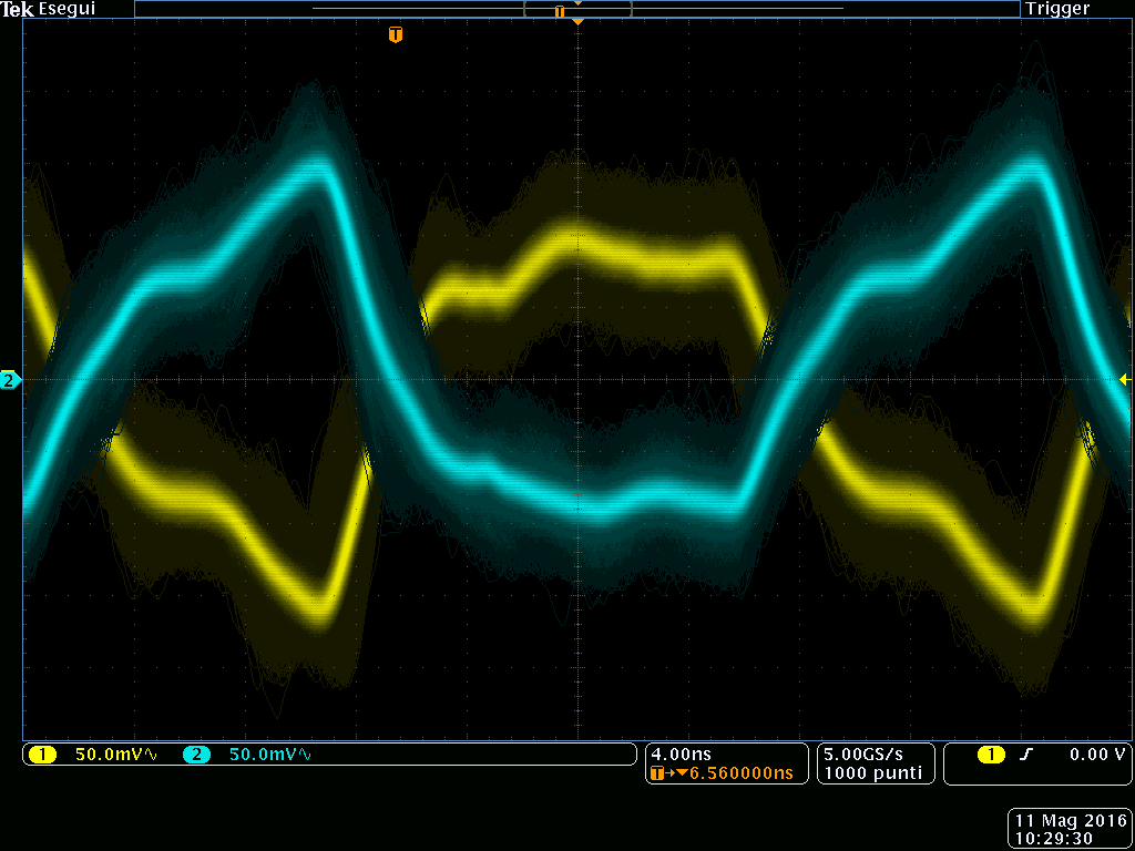

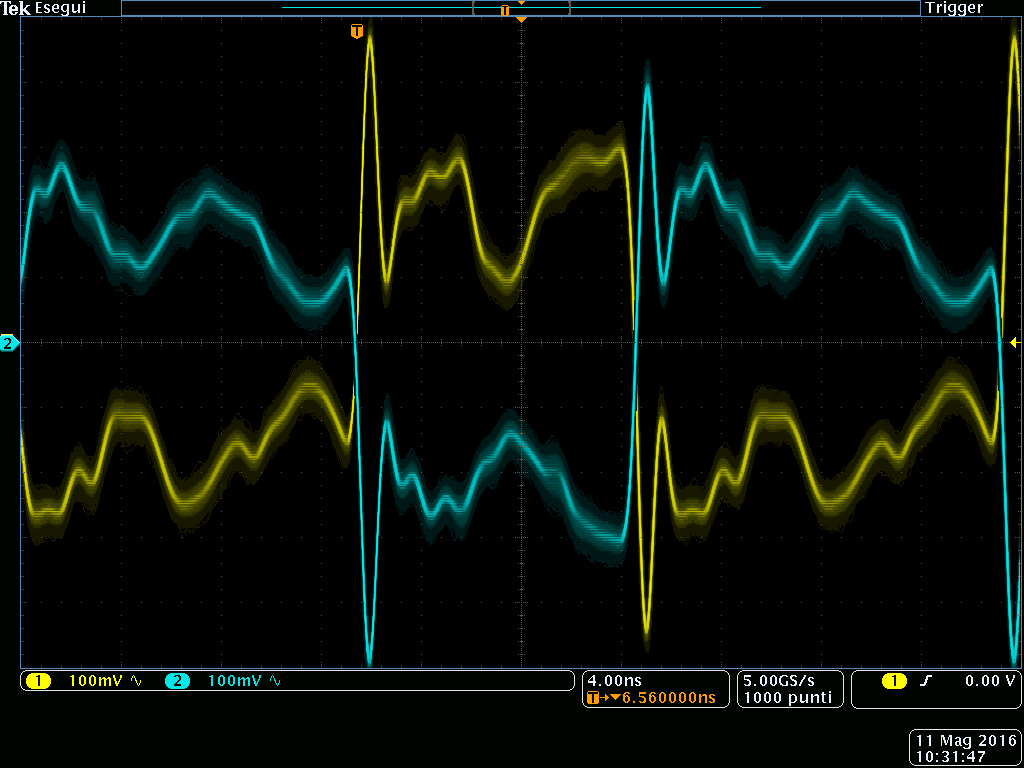

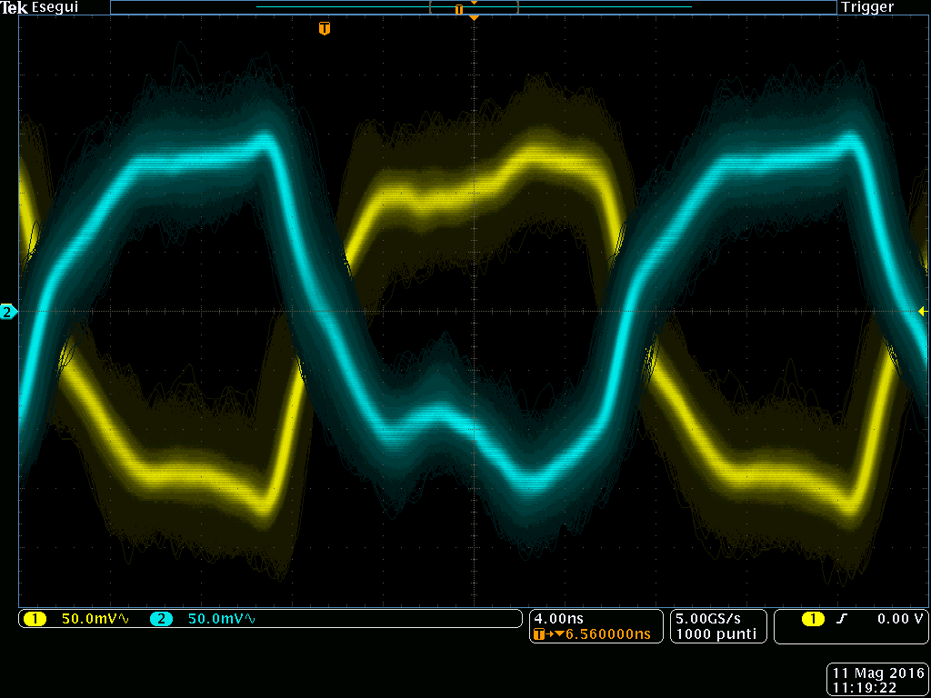

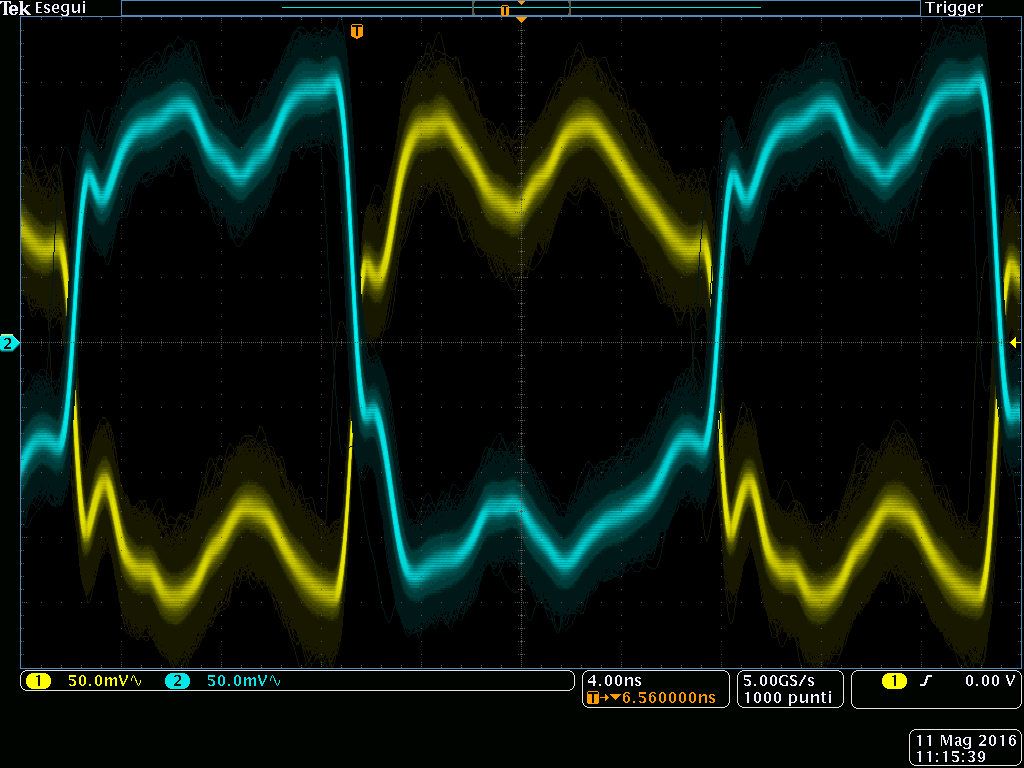

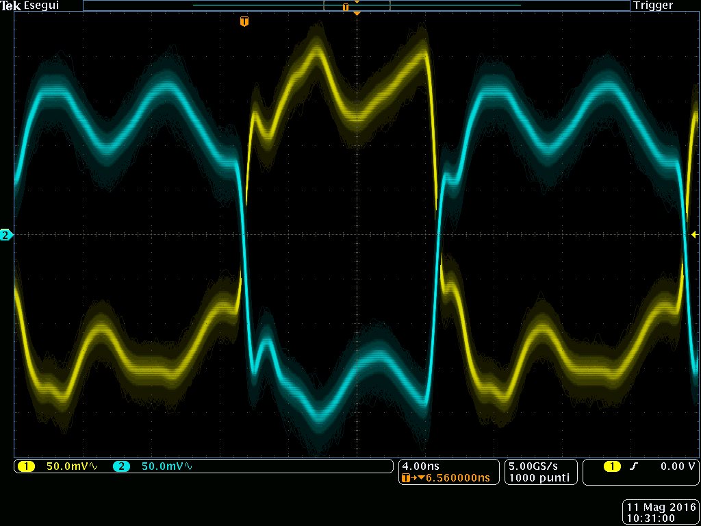

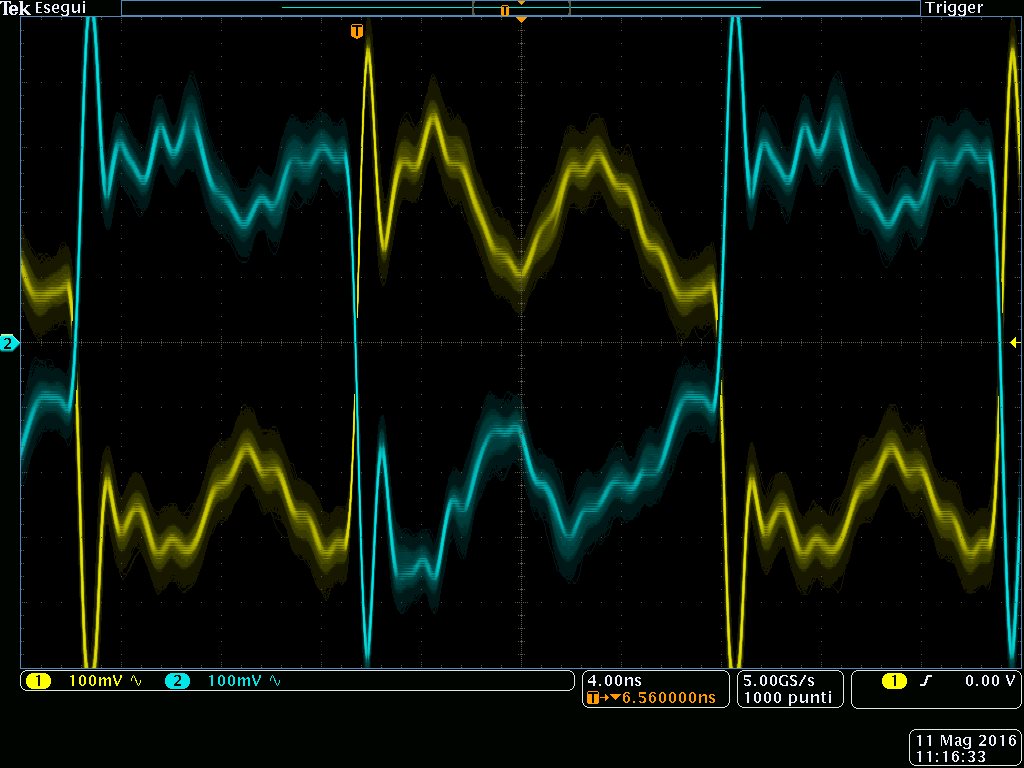

  • Hi Lee,
    I've uploaded few eye diagrams taken for two different cables:
     - 30 meters CAT5E cable
     - 20 meters Custom cable
    The diagrams refer to CLK signal. The CLK duty cycle is not 50% and depends on CPU internal PLL.
    The eye diagram for data lines can not be taken because the streaming is not periodic.
    For each type of cable I got 3 eye diagrams:
     - at the input of DS15BR400
     - at the output of DS15BR400
     - at the end of cable (input of LCD)
    Regards.
    Manrico
    CAT5E input of DS15BR400
    CAT5E output of DS15BR400
    CAT5E end of cable
    Custom cable input of DS15BR400
    Custom cable output of DS15BR400
    Custom cable end of cable
  • Sorry for the questions.  I cannot tell if the waveform distortions are due to the probe, probe location, or layout.
    What type of probe are you using?  Differential probes are best - single ended probes tend to create  waveform distortion due to GND inductance.
    What is the bandwidth of the scope?
    What is the setting of the DS15BR400?   It could be helpful to disable any output pre-emphasis to start with.
    Lee
