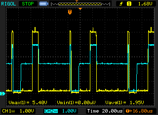

  • I think I found something interesting. I probed the DDC SDA lines at both connectors.  The sink (HDMI display screen) side looks pretty good. The square waves travel between 0V and 5V fairly cleanly. The source (GoPro) side, however, looks bizarre. It moves between 0V, 2.5V, and 4V. To me, it looks like there's a resistor divider being formed somewhere. See the screen shot from my oscilloscope below. Yellow trace is SDA at the sink connector. Blue trace is SDA at the source connector.
    Could this be some unintentional effect from the TPD12S016? Since the GoPro is a fully integrated consumer electronic device, it must already take care of the pull-up resistors on the I2C line, right? I wonder if the TPD12S016 is just complicating things because it has its own pull-ups. Any thoughts on this?
    Yellow: SDA at sink (HDMI display)
    Blue: SDA at souce (GoPro)

    Okay then, no external pull-ups is a good thing. Let me be sure: In the oscilloscope waveform above, is the "SDA at source" measurement on the system side (A-side) of TPD12S016? For now I will assume the waveform is the A-side.
    I notice that VCCA=3.3V, so the A-side should pull up to 0.8( VCCA), but it looks to be pulling up to 4V.
    Is it possible I can see SDA on both the A-side and B-side?
  • Guy,
    I was actually referring to the HDMI connectors themselves when I wrote "source" and "sink" in my previous posts. I was probing the SDA pins on the HDMI connector going out to the display (sink) and the same pin on the connector going out to the GoPro (source).
    Even though the TS3DV642 doesn't have any internal pull-ups, I'm pretty sure the GoPro and/or the display does. And apparently so does the TPD12S016. The 4V I was getting was almost certainly a resistor divide between 5V and 3.3V. I still don't know where the 2.5V was coming from.

    If the source has pull-ups then there should be the same issue because it will be a low impedance path through the TS3DV642 (please confirm that Adam). So I think your approach is a good one: bypass the DDC past TPD12S016 to try and get the EDID exchanged and once that works, then see if the pull-ups between the TVS and the Source are a problem.
    With the bypass in place, have you taken a waveform of SDA yet?
  • I have and it's not what I expected. Now both SDA and SCL are just idling high and do nothing. No trigger I can set up seems to catch any comms at all.
    I've confirmed that the SDA and SCL lines are continuous from connector to connector and the green wires are not shorting together or to any neighboring traces. Now I'm just confused...
  • Whoops, ignore my last post. Now it's working!
    It appears the HDMI connectors I'm using on my PCB are maybe not the highest quality. When I wiggled the cable in the connector a little, suddenly the display sprung to life and is showing video. I can make the video go in and out by just tilting the cable back and forth. I'll have to source some better connectors going forward.
    Anyway, it seems there was definitely a conflict using the TPD12S016 with a GoPro. I think I understand now that the TPD12S016 was designed for "raw" video sources that don't already have the required pull-up resistors and such. A fully integrated commercial product like a GoPro will just conflict with it.
    Thank you Guy and Adam for your help with this!
    -Dan
