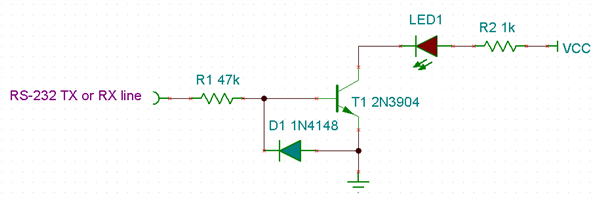

If we would like to add LED to blink when the data transmission
Do you have any idea about which solution could do that
  • Kai,
    There are a few ways to do this. This solution is simple and doesn't load the line much.
    When there is no data, the TX/RX line will be either be 0V or some negative voltage.
    This lights when there is positive voltage which should only happen on RX/TX line during data flow.
