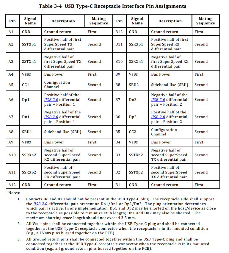

Hi Sirs,
Sorry to bother you.
We have use HD3SS3220, One question need confirm.
At datasheet page 26,
CC1 link connector A5 and CC2 link connector B5. Intel connector spec are A5 (CC2), B5 (CC1)
DM link connector B6 and DP link connector B7. Intel connector spec are B6 (D+), B7 (D-)
I think follow TI application schematic is OK but still need confirm it.
So could you please help check again?? Thanks!!
