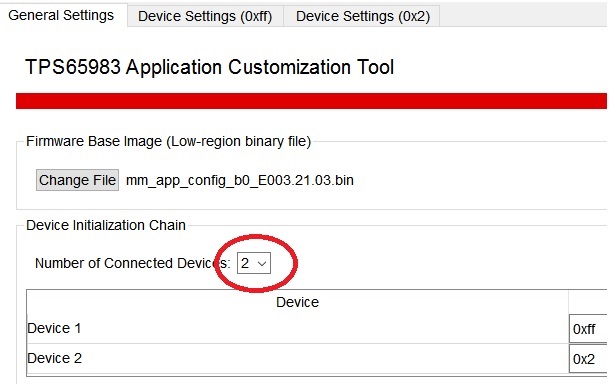

I use the latest TPS65983 config tool (2.5 Version) to generate bin file
I can generate bin file success when I select 1 device ,but when I select 2 device ,the tool can't generate bin file
Please help to double confirm ,Thanks
Thanks for pointing this out. I could reproduce the issue here. We will fix this in the next release of the tool.
