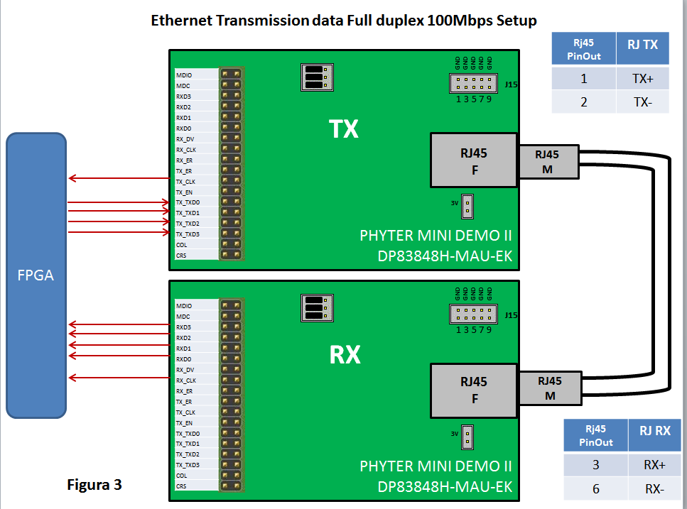

    I have a DP83620 as a transmitter and a receiver as DP83848.
    the two chips stay of two different board connected to each other via two RJ-45 connectors.
    I want to use only two conductors for communication as shown in the attached figure.

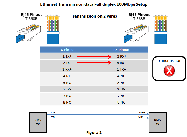

    I have a DP83620 set as transmitter (Basic Mode Status) 01h BMSR Bit 7 set = 1 transmitter is always transmitting regardless Link Pulse
    the connection between the two is set in this way
    RJ45-RJ45 Tx-Rx
    Pin 1 TD + ------> pin 3 RD +
    Pin 2 TD - -------> pin 6 RD -
    1) Can i set Dp83848 as receiver only?
    The transmitter operates but not the receiver.
    2) I can set set the registers of the two DP so as to maintain proper communication?
    3) you can use two DP83848 ricevutore one as receiver and one as always with a link of two conductors?

    When you are using a DP83620 as the transmitter and a DP83848 as a receiver, you indicate that the transmitter operates but not the receiver. How do you determine this? That is to say, how can you confirm that the transmitter operates as expected?
    You note that you are writing the BMSR of the DP83620. Are you also able to read the registers for both PHYs in order to determine their status?
    The DP83848 does not support unidirectional transmit. Writing to bit 5 of the BMSR will have no effect on the DP83848. Therefore, the same configuration you are using for the DP83620 will not work for the DP83848.
