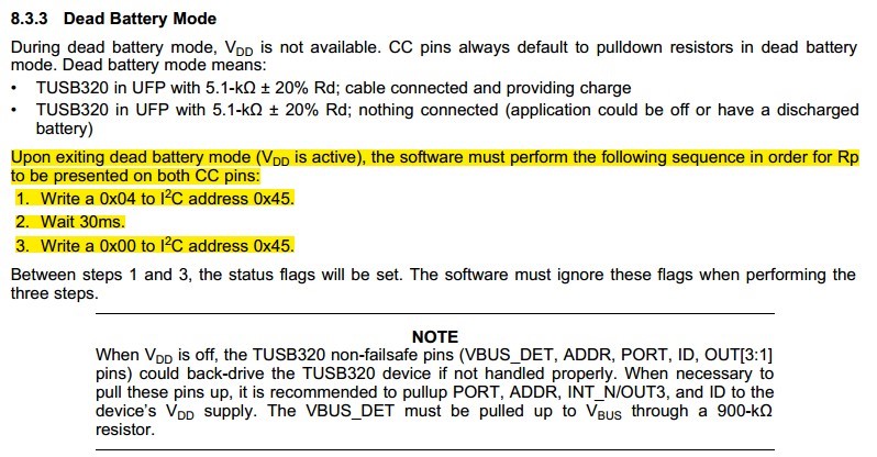

When shutdown the device, the VDD is off. So TUSB320 enter Dead Battery Mode.
Should we rewrite address 0x45 every time we turn on the device?
1. Write a 0x04 to I2C address 0x45.
2. Wait 30ms.
3. Write a 0x00 to I2C address 0x45
